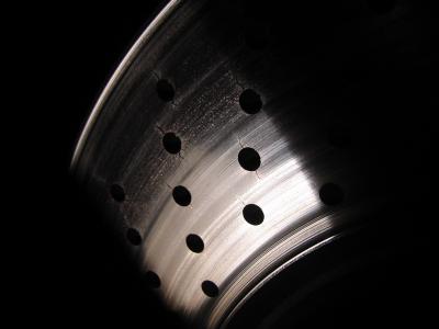

  5. I don't think the beveled holes will change things much. If you are just driving the car on the street, the rotors will be fine. If you are driving it hard on the track or autocross, cracks will form at the holes. The holes will also act a a cheese-grater and cause grooves in the pads and rotors. IMHO, the holes are there mostly for appearance. Modern pads do some out-gassing when they are first getting bedded in but after that, it's not an issue. The holes may also improve the initial action of the brakes in the wet but in general, braking in the wet is very much limited by tire traction rather than braking force.
