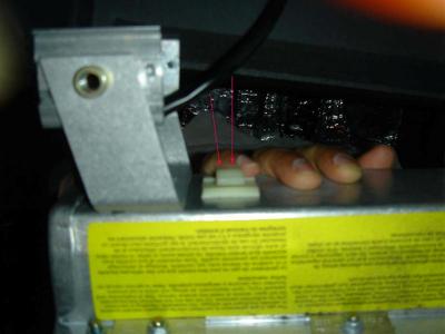

  3. Anyone know which way the yellow air bag electrical connector fits back onto the back of the air bag housing? The connector fits both ways, as shown in the two photos with the lead in wire coming in from the top and from the bottom, but which way is correct?

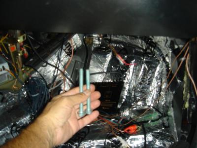

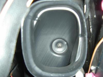

  4. Read the intro at the top and there is your answer. But, briefly, remove the right side air vent, unscrew the air duct which then loosens the black pipe underneath the dash. Remove this pipe; lay on your back in the passenger footwell and with a 13 mm socket, take out the air bag bolts. - About 30 minutes or so.

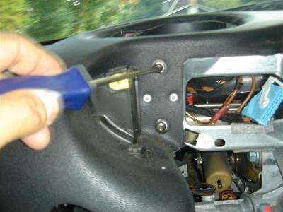

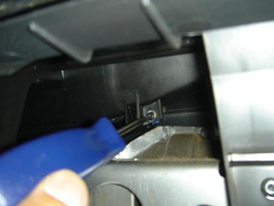

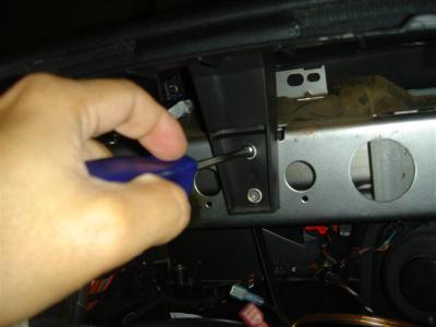

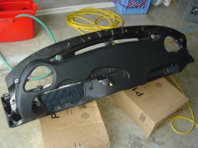

  5. Thanks for all who answered questions and otherwise supported my efforts in removing my 1999 996 dash so I could reskin it. What follows is a picture by picture account of how I removed my dash. Once you have removed both left and right side air vents, the headlight switch dial, the ignition key cover, the instrument console, the steering wheel and all its trim, the radio and all its trim, the alarm receiving unit and its trim, and both left and right side speakers, you can start removing the dash. The Pictures show every screw I removed but one – this one is located under the alarm receiving unit in the center if the dash right next to the windshield. I also removed the right side air vent Phillips screw so I could remove the black air pipe it connects to under the dash. The 2 13mm bolts that hold the air bag in place can be accessed when this black air pipe is removed. I laid on my back in the passenger foot well and looked directly up and found and removed the bolts. Once all the screws were removed, I pushed all the wires through their respect openings, grabbed the bottom right side of the dash with one hand and the steering wheel area with the other and pulled the bottom out first as I carefully rotated up and out. The install is just backwards. Good Luck.
  6. Yes, but where are they? And, it doesn't seem like I'm that far as all of the bottom is already loose and now its only the top. I just need to locate the rest of the screws and then its out.

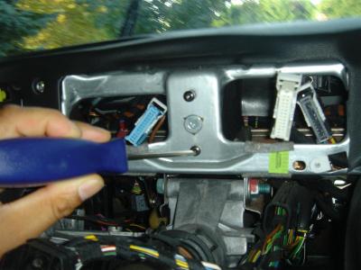

  7. I have all the stereo parts, speakers, air control unit, air ducts, and steering wheel off of my 99 996. While I have removed 4 screws on the bottom so te dash is loose at the bottom, 2 screws at the stereo housing and one by the center of the windshield, the dash is still on the car rock solid at the top. Where are all the screws and other clips or fasteners located? And, how do I remove the passenger side air bag?

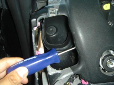

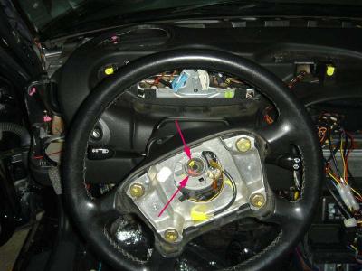

  11. Trying to remove the steering wheel and I’ve gotten as far as loosening the nut indicated with the arrows. After giving the nut a few turns so there is some space in the threads, the next step is to pull the steering wheel out a bit. But it won’t budge. What am I missing? Anyone know why it won’t come out?

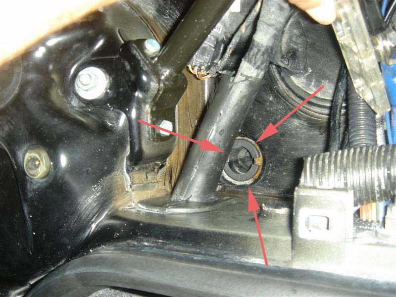

  13. Anyone know where I should attach the interior drain tubes in the rear for water to drain out of the outer compartment lid through the car and then out the exit? And I'd like to replace the old tubes with new one, are there any other tubes I can use or do I have to purchase Porsche OEM?

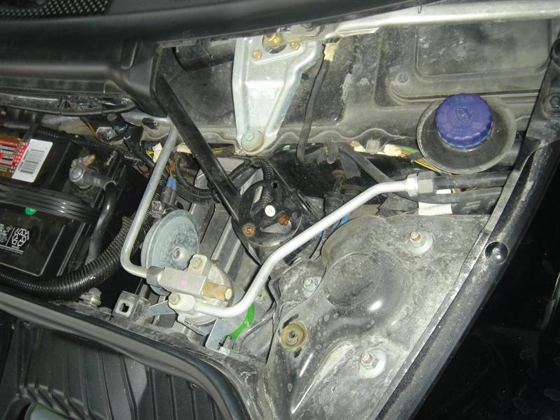

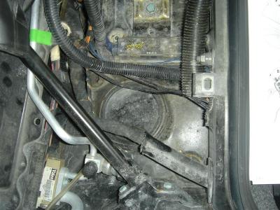

  15. Ok, I found and cleared all four drain holes in the front and I have taken pictures for the next person who comes across this. Notice that I took the battery out so I could get better access as I wanted to clean the interior area. You don't have to but it was a lot easier to see and get my hand in to clean the drains out. Thanks

  19. In the following pics, where are the drain holes for water to exit the car?

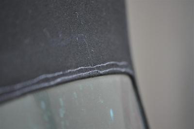

  21. If anyone has had a new plastic window for a 99-01 996 Cab stitched into their convertible top, would you please post close up pics of the stitching? You can PM me the pics instead if you like. Close ups like the ones in the attached pic would help. Thanks.
