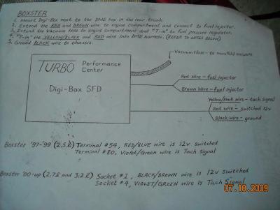

  1. Figured it out myself and the results are outstanding. As far as all the cars "blowing up", that is an ole wives tale.
  2. Thanks for all the suggestions everyone.
  3. I hook the yellow wire to the tach wire on the car and the tach stops. I disconnect the yellow and the tach works.
  4. For some reason my blackbox is different from all the rest. I did the following and the tach would turn off. I disconnect the box and tach would turn on. Red to 12v (red/blue) Yellow to Tach (violet/green) Black to ground Gray to injector Green to injector
