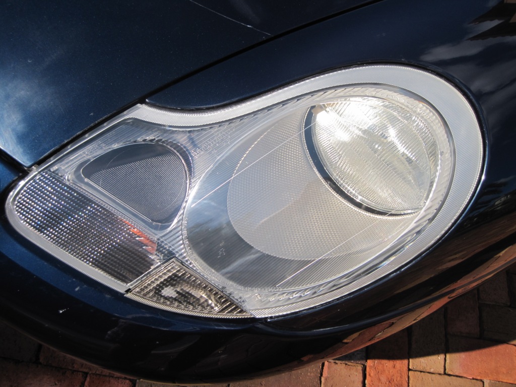

tcrown's Achievements
  1. just as one more plug for the company/guy who came out and did my headlights, he used a pneumatic air sprayer to apply a clear coat epoxy at the end.... he described that as one of the main differences between his process and standard kits. it is a UV protector and the company guarantees no future oxidation. having said all that, i will NEVER be using a machine to do anything on the exterior of my car again!
  2. thanks for all the replies. i'm so relieved with my outcome. my local porsche dealer recommended www.drheadlight.com. they have dealers in 10 states or so. John, the owner of the South FL location, came to my house today and in 90 minutes completely resurfaced my headlights - they look new. i'm pasting pics of the afters. unfortunately i never took full befores, but the closeup is the same headlight that i damaged 2 days ago (shown above). my headlights were pretty dull and foggy prior to this weekend.
  3. F me.... what a disaster. any reco's on where to buy headlamp covers? i've done about 20 min of research and sounds like i have to buy the whole assembly.
  4. In an attempt to remove the oxidation off my headlight covers, i bought a 3M sandpaper/polish kit from autozone that came highly recommended by the manager. the sandpaper padding attaches to a drill. I feel like such an idiot..... Despite following all the instructions, the sandpaper has created white marks that seem permanent. they're not really scratches as much as they are just opaque marks that seem embedded into the plastic. Have i ruined the headlight? I re-did the entire process hoping a second round would remove the scratches. What are my options here? i am literally sick to my stomach at the thought that i damaged my baby. it looks much worse in person - the pictures don't capture the extent of the marks.

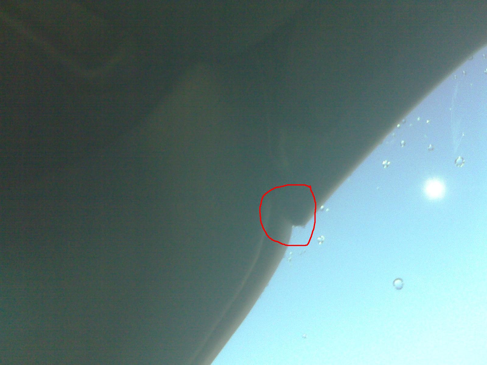

  5. Hi - Two days ago i noticed a small leak in this spot. The water drips very sporadically... The drips increased when i started driving, and this was hours after it had stopped raining, so that to me implies that it's a leak out of some drain (?) The weather seals look fine... I can't seem to figure out where the water is coming from... i'm attaching a picture of the leak with the place where the water drips circled. the water drips right out of the corner onto the passenger seat. the picture is pretty terrible - sorry. any thoughts on what to do? i searched for cab water leaks but there didn't seem to be much past history.
