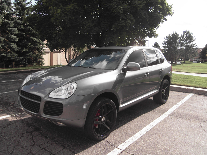

  2. Thought I would share the new ride from Michigan.
