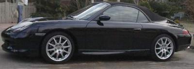

  4. Thanks for the replies. Good stuff! Here's a pic of my car as thanks! Jeff
