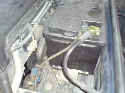

  15. Thanks Loren/Toolpants. I'll take some more photos tonight and look for the brand name.
  16. Thanks Ed, That makes sense, as the battery was replaced about 14 months ago just before I purchased the car. No doubt my new battery doesn't need it? I'll have a good check anyway. Many thanks, again. Dave
  17. Chaps, Whilst installing an alpine sub this afternoon in my '99 996 C2 CAB I came across the following clear tube located close to my battery. One end of the tube is open and looks like it should be connected to something, where the other seems to dissappear into the top of the front right hand wheel arch. Any ideas on what it is for?/where it should be connected? Many thanks, Dave (dcboxster)
