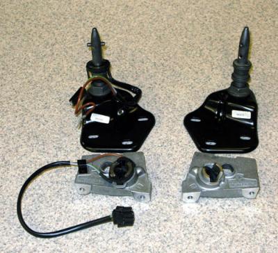

  4. I have the older style hardware, but the same on the car and the top. I attached a photo of the hardware I have. (Photo credit to Orient Express from a thread on Rennlist!) If you look at the male portion of the twist pin, there is a hex bolt above and below the plate that looks to me like it can be loosened/tightened to let the shaft rise and fall. Mine looks like the passenger side has already been adjusted, ergo, the passenger side looks to sit 2-3 mm lower than the drivers side. I've looked high and low and can't find any documentation regarding this topic. I appreciate any feedback.
