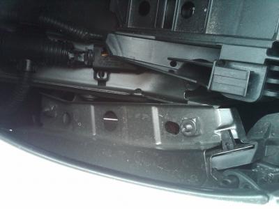

  4. Dont forget on the 955 you have the turn signal, turning lamps, running lights, halogen and xenon bulbs all on that cable. I think the 957 only had two lights in the head lights. The picture I attached is the cable that goes to the headlight. They dont do the cartridge plug in style connector anymore, I assume because of all the problems they had with 955 loose connections.

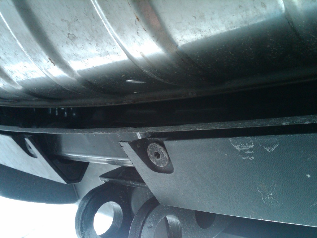

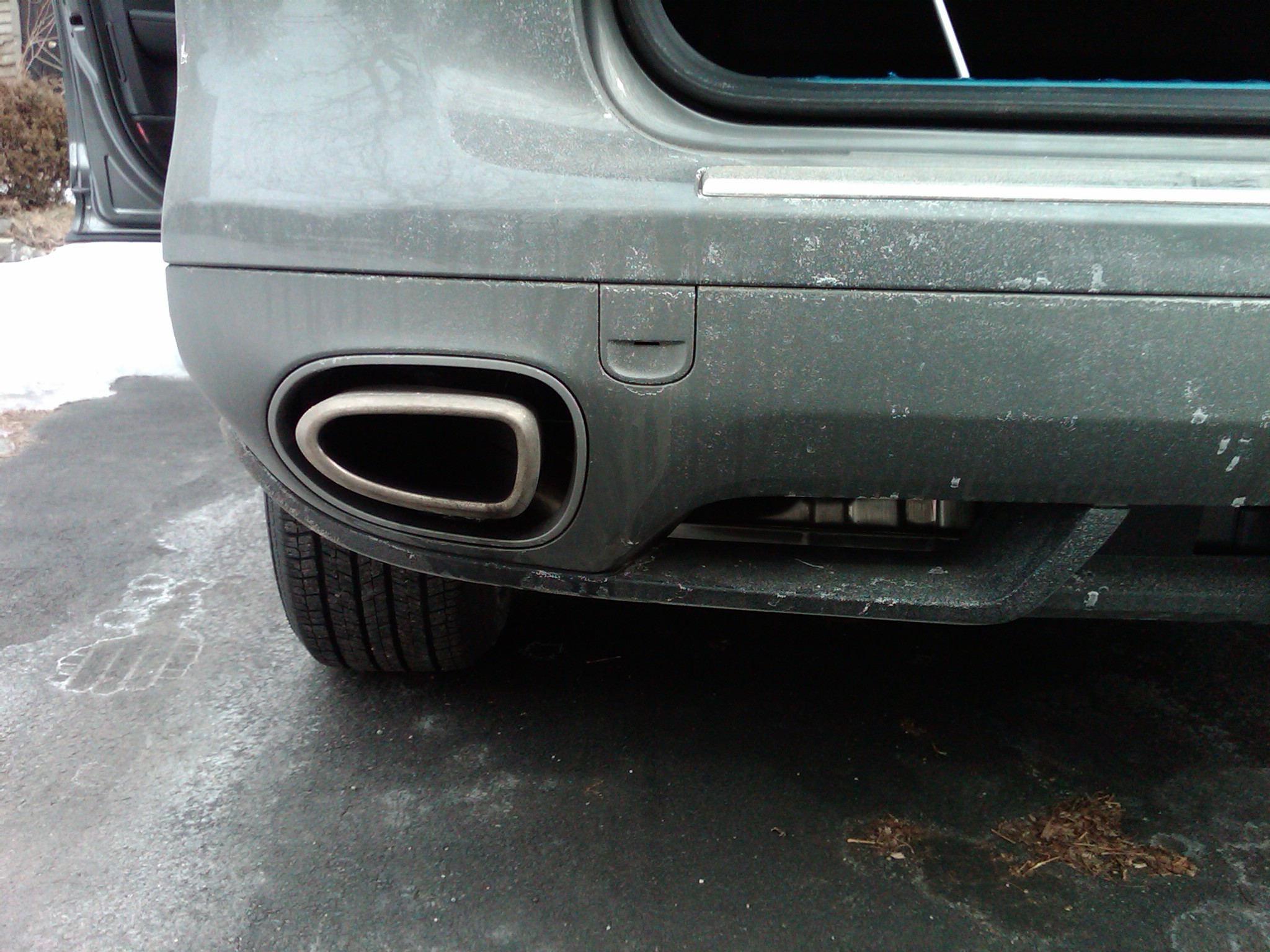

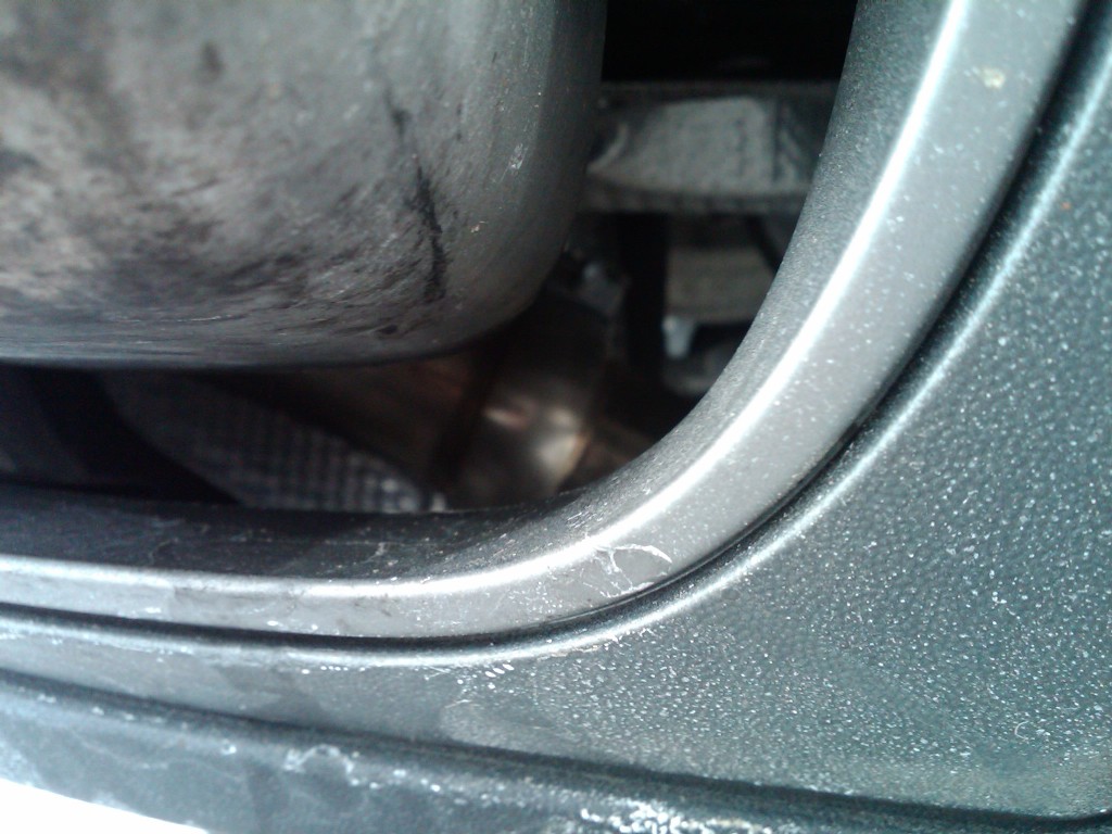

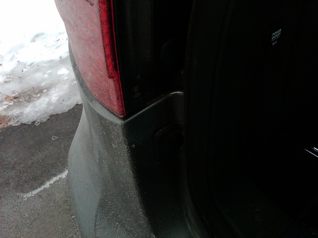

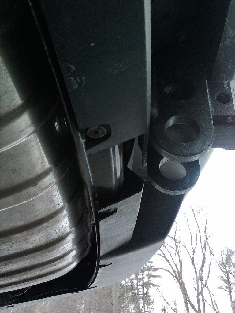

  5. So are you saying the lower half of the rear bumper can just bolt on? I would like to leave the upper half the same, and just remove the part that covers the exhaust and replace with the newer valance.

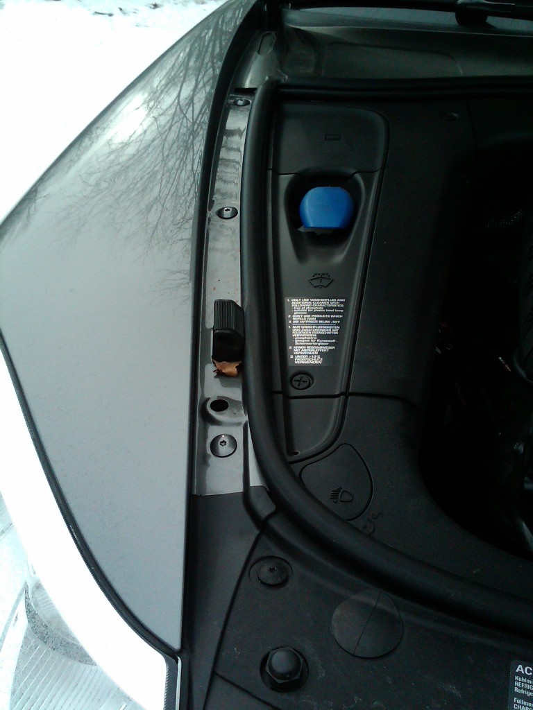

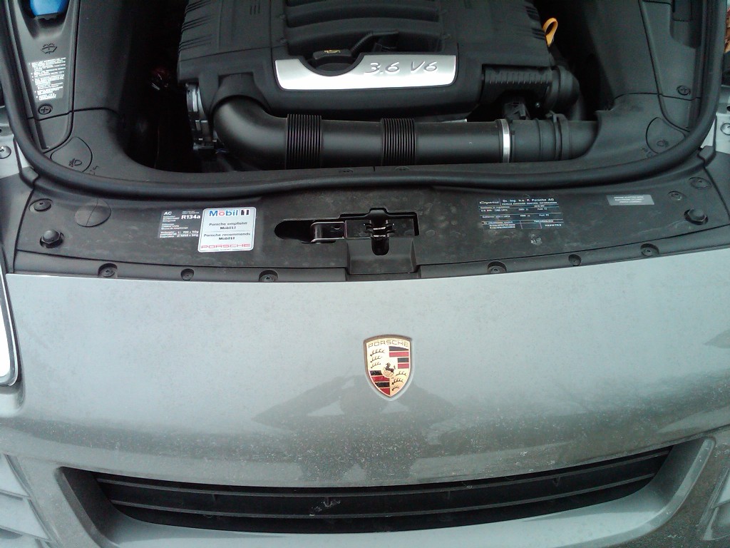

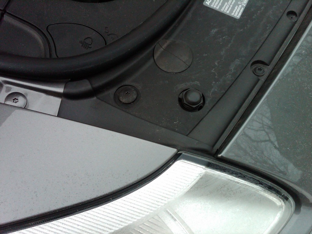

  7. And more... and more... And more ... And more ... Last set again to keep in one thread. Let me know if anyone has questions about what the shots are, I tried to get all the connection points... This is a 2010 Cayenne v6

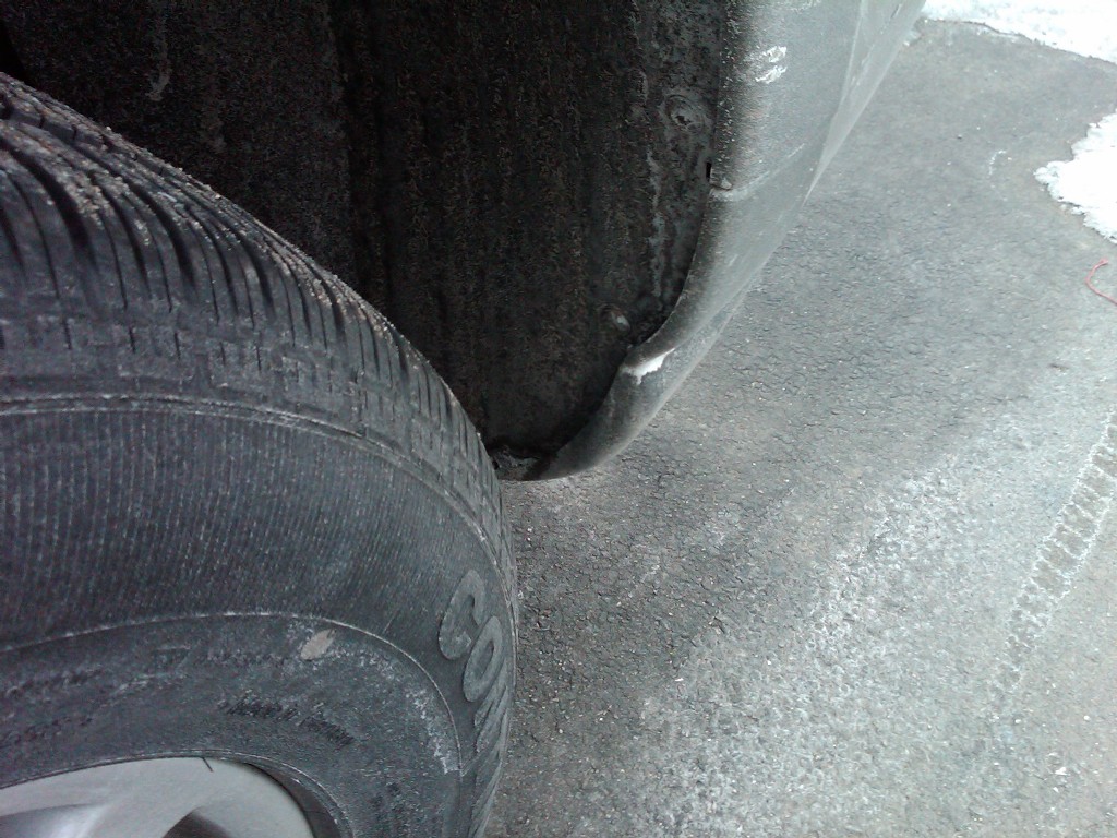

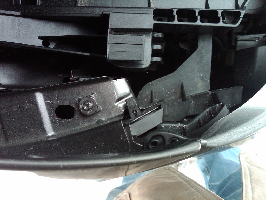

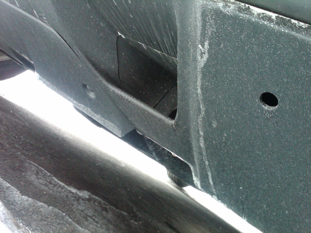

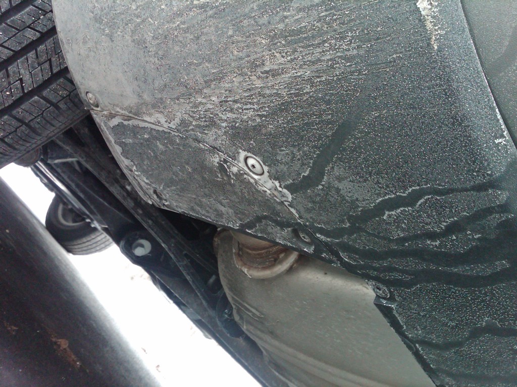

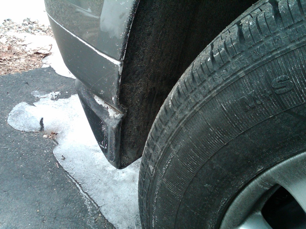

  8. :) Here are the pics, looks like a few more things will be needed, like wheel wells, rear bumper brackets, etc.
