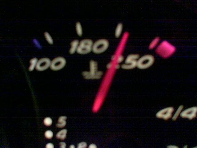

  20. whenever i drive my Boxster for more than an hour the temp goes up to more than the half as you can see in the picture. the coolant level is ok. if i turn off the air conditioner the temp goes back to normal (ie. half). i live in a very hot country and these days the temp is around 120 Fahrenheit (50 celsius). the specs are as follows:- boxster (2.7) model 2000 tiptronic US specs 60k kilometers so please let me know if this is normal or there is something wrong? if something is wrong what can be the cause? thanks.
