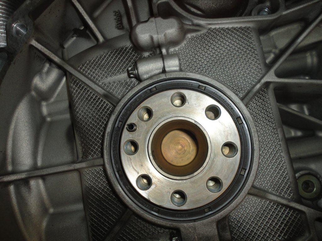

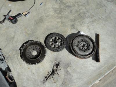

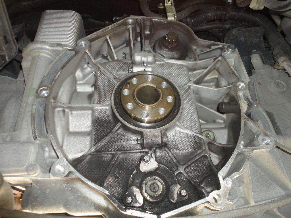

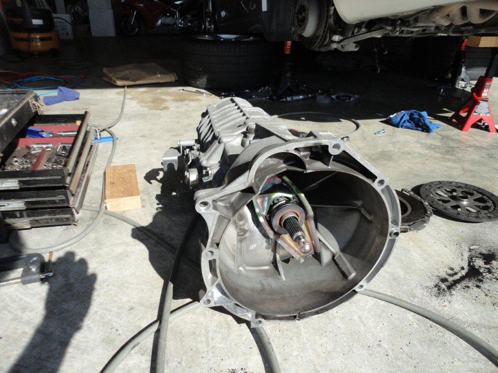

  9. Ok, sorry for the delay on uploading the pictures...but after holidays, NYE, etc... I'm finally ready! As for the steps, the link given by Steen (http://www.c-speedr....996rms/rms1.php) shows everything that you need, with minor differences (for example the shift cables are slightly different but not much). As I mention on Dec 20th, the slave cylinder is a "lovely" piece of engineering and it will give you trouble...whatever you do don't take it a part, it won't help....try to have in place before the transmission is all back, if possible, if not you will have to work to get in place. So here are a few pictures, not much since the link above give you a very good step by step explanation! Thank you very much for all your help!!! My next step is to fix the airbag error, I will be placing the link below as soon as I have the topic started. securing the car. removing axles securing transmission Pressure plate, clutch disk and flywheel (we actually believe that the pressure plate was the problem) Engine - IMS happy to see that it was dry, only clutch dust New seal New clutch and pressure plate in!
