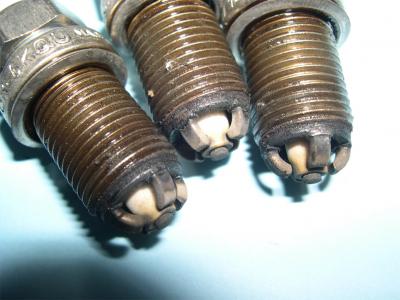

  2. Haven't made much time for the Boxster lately but I did get the plugs changed. I found both Beru r6 336 and r6 310 plugs, I'll assume for now they're equivalent. But I never had seen a plug where the gap appears set below the base of the center electrode. Again for now I'll just assume that's the way Beru plugs are configured.
