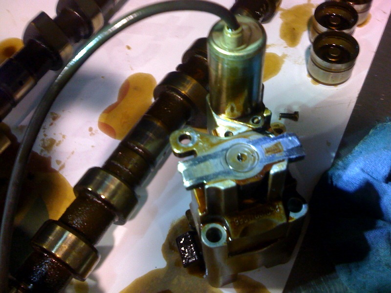

  6. It was really pretty easy, compared to a later m97 (put a cam in one 2 weeks ago), I didnt even remove the wheel, no clearance issues, you just have to be careful with the exhaust lifters they like to slide out and bounce. Im debating whether to replace those pads or get a new tensioner element its pretty chewed up.
  7. well we were slow today so I decided to pull the cam case off and look at the tensioner. Sure enough the slider one the external tensioning element is gone. The chain was riding on the metal pad on the tensioner, Im glad i didnt run it after getting the codes to show. I think this is what txhokie was mentioning thanks a ton. I have a pic ill try to post.
