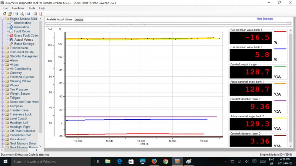

  4. Load tested battery off terminals. Indicated a good battery for a 100amp needle tester. I read a post from another forum where someone mentioned when the timing chsin stretches the symptoms will affect bank 1 only and have tough idle that clears up when the engine is under load. Can anyone confirm this or refute it?

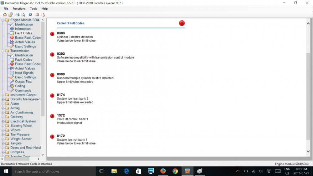

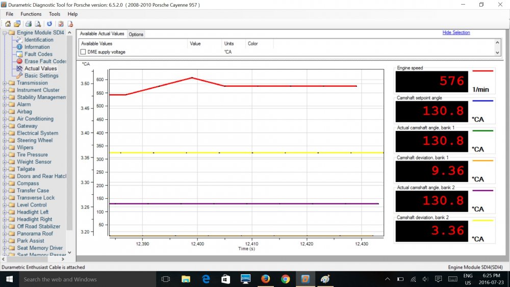

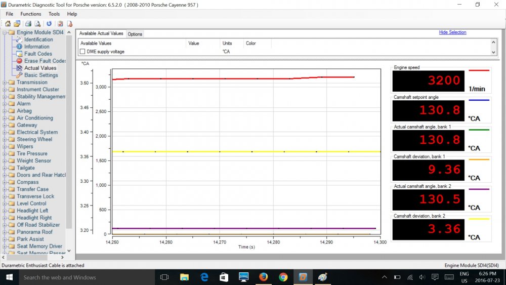

  7. UPDATE - I did a load test under the bonnet and the load tester needle was on the better end of nearing "weak" indicator. So, the battery is far from terrible. Also, just for comparison I load tested my Touareg TDI the same way and got an almost identical result and my VW has no issues. I didn't have time to pull the seat back to test off the battery directly, but would my result differ straight off the battery terminals compared to the engine compartment connections? Secondly, I tested ALL 8 plug connectors for the coil packs with the ignition turned "on". All 8 connectors gave me a 12.17V reading ... so this would mean they are getting power and have continuity. Oddly enough, with the Xenon headlamps running and ignition turned to the "on" position, after I went to start the engine I got a PSM failure flash on the instrument panel. Shut the engine off. Started again and it was gone. Is this one of those unexplainable faults as people mention with a bad battery or low voltage after I had been draining the battery while I ran diagnostics? Lastly, I used a fog machine fitted with some tubing to direct the fog into my intake manifold. Thinking a vacuum leak may be possible. I checked all over the sides, rear, and intake area, but no smoke came out anywhere. However, I am not sure if the party fog machine has sufficient pressure to force fog out of potential leaks. Thus, I am not saying I would rule this out, but preliminary tests indicated no leaks. I did this fog test because my misfire on cylinder 3 only occurs at idle and not driving. What I do now is drive normally, fast and slow, but when I see an unavoidable stop coming I begin to left foot brake and just as I stop I am already using my right foot to raise the RPM to around 1000RPM. Anythign over idle, even 1000RPM, stops the misfire and the engine runs smooth. ?????????????????? Can anyone tell me how to definitely rule out the variocam adjusters attached to the front of each intake camshaft? Sometimes they're referred to as vane adjuster, cam phasers ... these are mechanical gears that are fed oil from the electronic solenoids. Lastly, does anyone know where I can get a DME re-flash? Is it a dealer only service and what would it cost? Does it need to be removed from the vehicle or can it be doen via the diagnostic plug for OBD II ? Thanks for any input. Something is better than nothing and even something you may think is common sense or irrelevant may very well prove to be valid. Keep the replies coming ...
  8. I will hold off for a couple weeks on re-timing. I ordered a smoke machine to aid in checking for a leak. I disconnected the mafs and symptoms remained so that ruled those out. Another thread mentioned the variocam vane adjusters use a diamond friction washer and sometimes at high rpm they can slip. Is this something that is possible or would i see all bank 1 cylinders with faults and misfires? I checked my battery and on cranking it dipped to 9.4v. I have heard 9.6v is the threshold so maybe my battery is the culprit? How can I check if #3 cyl is getting 12v to the coil pack... just probe it with a multimeter? Will update when I have more info ...

  11. I have changed coils and plugs between banks thinking odd chance brand new coils were manufacturer defect, but problem remained on bank 1. Also, plugs for all cylinders, misfiring included, were of the same normal appearance. Not oily, no raw gas, not overly lean looking. The wiring themselves have been plugged on and off multiple times by me, dealer, and indy. They must be secure. One thing I am unsure of is how to check if the plug harness itself is receiving power??? The furl trim is much better than before, but you are right, one bank is rich and the other lean which led me yo believe the computer for DFI is compensating for a timing problem? I also thought if the variocam gear on front side of each intake camshaft, say failed in the high position, I would have lift control faults on all bank 1 cylinders and explain the rough idle, but still have top end power as usual.
