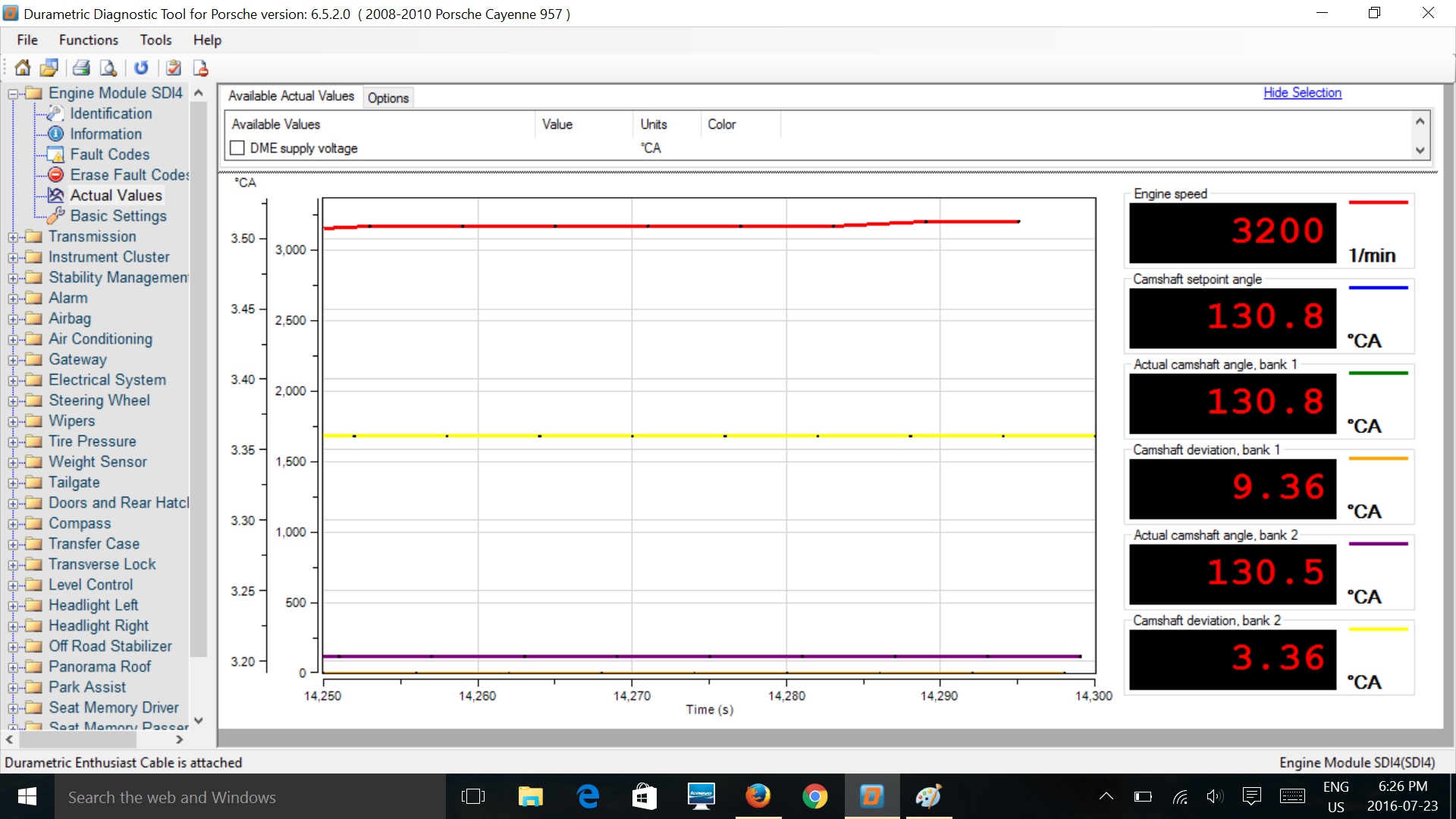

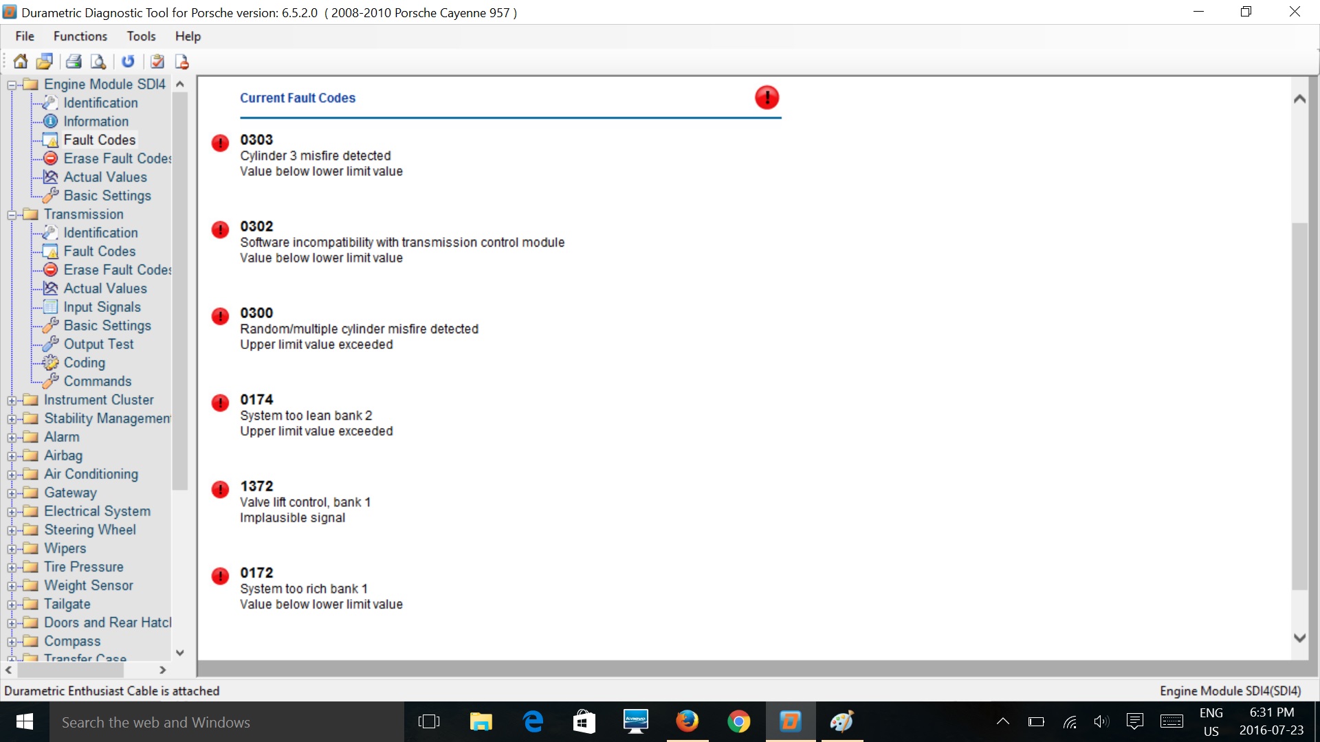

	I am praying anyone with some expert knowledge or past experience can help me with my valve lift control fault codes and misfires all on bank 1. Please see the 5 attached pictures from my Durametric. Vehicle is a 2008 Cayenne GTS with 90,000 kilometers. 4.8L V8, automatic. Several months ago I got a CEL coming off the highway from about 135kmh to a stop. At that moment the CEL illuminated and the idle became rough and felt too low. Get home with full power and code only shows valve lift control fault on bank 1. Read through forums and common fixes … thus far I have replaced several parts as I will briefly elaborate below: All 8 coil packs & plugs, valve lift control solenoids on both banks, cleaned MAF’s, changed air filters, all 8 fuel injectors, cleaned backside of intake valves, cleaned air intake and throttle body (re-calibrated throttle position), disconnected battery for hard reset of modules to re-learn, swapped camshaft position sensors between banks. I swapped coils/plugs as well to see if the problem would follow, but it only affects bank 1. Valve lift control solenoids and fuel injectors are the newest part revisions. I did a compression test, leak down, and borescope. I had a master Porsche mechanic at an independent shop verify my numbers are all similar and within reason. Nothing out of the ordinary. One strange after effect from cleaning the intake and after swapping injectors for new ones was the rough idle was at that time much smoother and stable, BUT when I took it for a drive at about 3500 RPM it felt like the engine was being held back and the RPM’s wouldn’t increase as rapidly as it did when the idle was rough. So it was evidenced to have smoother low end idle, but almost like a loss in top end power … maybe variocam wasn’t active??? After the engine cooled overnight and I drove it the next day the rough idle returned, BUT I once again had rapid RPM increase at higher RPM and full top end power … the exact opposite of the day before. This phenomenon was replicated three times. The first time was after spraying CRC intake valve cleaner into the running engine. The second time was after doing the compression and leak down tests (plugs removed of course and turning clockwise at the crank). Third time as mentioned above. However, after each time it’s the same scenario, let the engine cool overnight and rough idle as usual next day with full top end power. This is how it is at the moment. I have read forums for hours, visited a Porsche Premier dealership, and been to a master Porsche tech shop. The dealer wasn’t too investigative for my liking and their diagnostics are very expensive. The independent shop is thinking it may be a timing issue and wants to reset timing. My Durametric pictures show the cylinder banks are off by about 6 degrees compared to one another. The indy also recommended the fuel injectors judging by the fuel trim values, which are in all honesty a bit better now because they were double digits previously. SORRY THIS IS SO LONG, BUT BELOW IS THE POINT OF MY POST NOW. I have the fault codes shown in my attachments. The software incompatibility with transmission control module fault is a new strange one that only came up after the 2nd and 3rd time of having top end power loss with MAF fault codes … like it was suffocating for more air, but shifted rough in anticipation of a rapid RPM climb. At the moment the transmission is both auto and manual sport shifts fine. When idling rough, cylinder #3 misfires constantly. In a span of several seconds it has misfired in the double digits. HOWEVER, as soon as I drive, whether easy or hard acceleration, the misfires are gone. The misfires only return when nearing a stop (<10kmh) or when stopped at idle in park or drive. My fuel economy is still giving me about 500km out of a 90L fill up … so I think that’s typical. Being that I have replaced some common parts for this problem here is my theory I hope someone with in depth knowledge can confirm may hold true or is completely off and impossible. Perhaps rare, but is it plausible coming down from a high speed run off the highway that my timing chain could have jumped a tooth or teeth? Is 6 degrees variance between camshafts tolerable? How many degrees is 1 tooth on a cam gear? Being the chain is 1 piece, the tensioner is only on bank 1 side, is it possible the tensioner has failed and allowed slack on bank 1 to jump a tooth and change timing? Is it possible the chain is stretched at 90,000km? I bought the timing tool kit and have a rough idea of how to do it. I would turn the engine by hand after the job to ensure the valves clear the pistons. If I am unsure I will just tow it to the indy. Does anyone have a timing procedure or link to a write up for the V8? I appreciate everyone’s input. I am frustrated and tired of throwing expensive parts at this problem. I am waiting for my timing tools to arrive. This is my last resort. Beyond a timing issue I am clueless. If it is timing, I am not sure why cylinder 3 is most affected. Sometimes cylinder 2 gets an occasional misfire, but nothing near as frequent as cylinder 3. The other cylinders must be firing fine, but valve control faults may be due to not seating correctly with TDC due to timing??? My thinking as that the misfire ceases at anything above idle because the timing chain now has a bit of tension applied to take up slack or advance timing? Is this why I have excellent top end power range and able to cruise along through the city without misfires until I slow or stop??? Thank you for your help and hopefully someone can solve this puzzle who may have gone through what I would like to believe is an extremely rare occurrence before I lose all faith in Porsche quality. ***If you need me to grab any live data from Durametric for pictures to verify something let me know.
