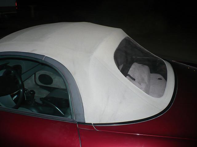

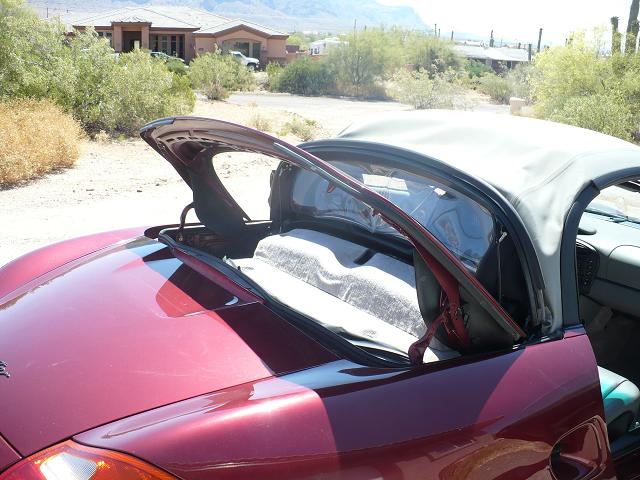

  2. OK... looks like I just had to brush it a little harder... After using convertible top cleaning solution and a nylon brush, I rinsed and let dry twice. Top is much more grey now! Will try to post pic. I ordered some RaggTop scotchguard and treated top. So I suppose it was the original top color all along, just that it was dirty and/or faded, so the vigorous brushing probably just removed the dirt or top layer of UV degraded canvas. Just in time for the Monsoon season here is AZ! Thanks for all your help :thankyou:

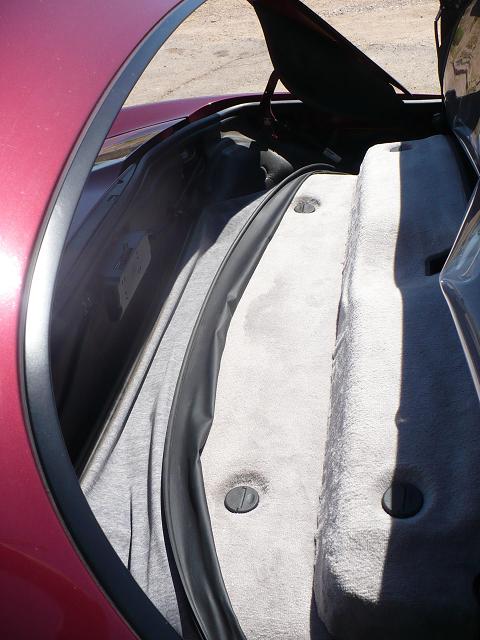

  3. Again, thanks Maurice. Yes, it did not look right to me, but I couldn;t figure out what the function of that sheet of vinyl was. I'll look at it more closely next time. Right now, I'm not too worried, it's 110 F and 5% releative humidity here in the desert with no rain in sight!
  4. Thanks Maurice. My picture does not show the real color very well, but yours looks definitely Graphite Grey, mine is more Tan. So, the top color must be fading because I scrubbed the heck out of it and did not change color (not dirty). I don't mind it all that much, just that it doesn't match the interior color. How hard is it to do a die job? Should I die before I Scotch Guard it? What is that grey material hanging from the gasket? When I worked on mine, it was just laying on the carpet...
  5. Here's a better picture. It's actually more tan than it looks in the picture here. If you look closely, it fades a little where the roll bar is.
  6. OK, here's the picture.
  7. I believe the top color options on the '99s are Graphite Grey, Metropol Blue, and Black. Since your car has a grey interior I'd lean toward the Graphite top. If it's showing a tan color then the top color is fading. A pic may confirm. there are products out there for dyeing the top, that others have used with varying degrees of success. A good soak 'n' scrub with car soap and a microfiber mitt may help pull out any contaminants that mask the factory color, so I'd start there first. Porsche and others make top protectants and conditioners with UV protection to help keep the top in "tip-top" shape. Mark I bought some Convertible Top cleaner and tried spraying it, then rubbing the area with lintless cloth, then soak it up with a damp clotch, but did not see any change in the color. Do I need to use a horse hair brush to get the embedded dirt out? Or is it just the color fading... Here's a picture, althought the sunlight distorts the color a little. I'll get a better pic tomorrow since it's dark out. It's definitely not graphite grey.

  12. 99 Boxster, 5 speed, Arena Red, light grey interior. The top on it is more of a Beige color. I wonder if this is the original, but doubt it since I believe it came with the light grey color color top. How can I tell? Or, is it just dirty? Thanks

  14. New to my 99 Boxster. Replaced the MAS, air filter and fuel pressure regulator this morning, and found the dreaded broken plastic ball joint on the right convertible top side mechanism. What is the soft material that clips to the rear? Is it just supposed to lay like this?
  15. I was working on my 99 Boxster today and noticed the right hand side ball joint on the top mechanism was broken. Here's a picture. The top had been working (and still is) correctly. I'm sure the other side would fail given time. :eek:
