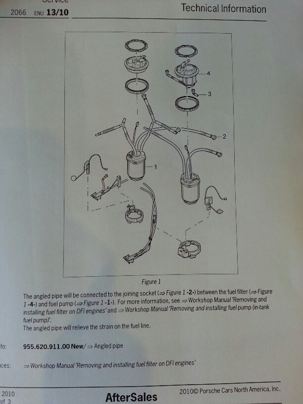

  9. I ordered the right pump and updated left filter/ flange this afternoon.. The part number on the old left pump is 7L0-919-087. I will see if I can find one online, otherwise I will call a VW dealer in the morning. Schematic of updated system attached.

  11. Hi All, Ive been searching the forums for a couple of days and I can not find the answer to this driver side fuel pump issue I have. I ordered a new pump from Sonnen and it does not have the tube that connects both pumps and splits into a Y to connect to the passenger side regulator. The tube does not have a normal "squeeze" release at either pump and there doesn't appear to be any place to connect it to the new pump. I was told in an email from Sonnen that I have to get a new updated driver regulator and passenger side pump, I will call tomorrow to get more info but it does not seem as though anyone else on this forum has had to do that and the part number they gave me doesn't appear to resolve the tube issue either when I look at the pictures. Heres a post from Cayenne69 where it doesn't seem as though I should be having this issue. http://www.renntech.org/forums/topic/36724-fuel-pump-replacement/?p=194716
  12. Hey guys, I am changing my left pump and there is a tube that is connected to my old pump that doesn't have a release on it.. It is glued maybe? And when I reach into the tank there isn't another connector that I can feel, I am assuming it goes to the right pump.. If I open the right side and find the connector, will I be able to connect this tube to my new pump or is there a different hose I need to buy?? I will take a picture if this is too confusing.. Thanks!!!
  13. There is one extra hose on the old pump that isn't on the new pump that I ordered from Sonnen. It connects to the right pump and splits to connect to the right regulator. Im going to see if I can avoid changing both pumps and dropping another $350 into replacing a part that works fine.
