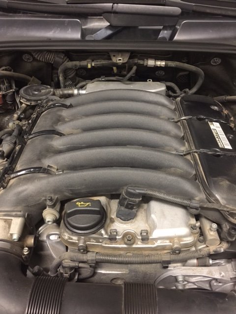

  2. I suspected those were AC line. I found the valve! Bottom right in enclosed pictures (the second pic shows cover off). Is there more than one valve? Thanks again!
  3. Is one of these in picture the Schrader valve to test fuel pressure? Thanks
  4. Hi thanks. I got fuel pressure test kit from AutoZone. I can't find the Schrader valve to hook up to. Can you help me locate the valve in the enclosed picture of the fuel rail? Thanks!
