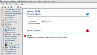

  4. Thanks for the helpful ideas. I reselected the vehicle manually in Durametric (6.3.1.7). As a result, it read "2005-2012 Porsche 911 997" (screenshot attached). Airbag fault is still there, and it cannot be cleared permanently. I popped out the "Passenger Airbag OFF" light out of the middle console, and took it apart (2 snaps) to observe the 2 LEDs directly. Even when the light is not illuminated, I do see the 2 LEDs illuminated VERY dimly (dim enough that you cannot see after putting it together). Not sure if there is perhaps a short somewhere which is causing some current to flow even though the light is off -- or whether this is just by design.

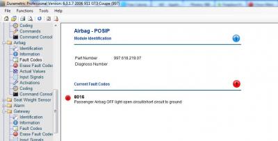

  6. Hi Loren: Thanks for the reply. It is a 2006 C2S Cabriolet. It appears to be 8016. (see attached). I tried unplugging battery for 1 hr, and plugging it back. Same problem. (and cant reset it.) Thank-you
  7. Hi Everyone: My airbag light remains on now. I hooked up the durametric, and the following fault is reported in the airbag module: 8016Pasenger Airbag OFF light open circuit/short circuit to ground Has anybody ever encountered this before? I cannot clear it (it comes right back). My "passenger airbag off light" appears to be working - I was able to illuminate it by putting a light object on the seat. Thanks
