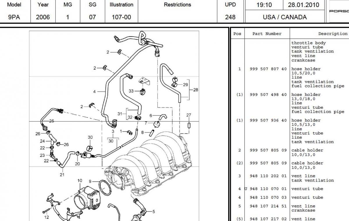

  1. Maybe I missed it but a quick look I didn't see it. Its in there somewhere www.porsche.com/all/media/pdf/originalparts/usa/9PA_USA_KATALOG.pdf

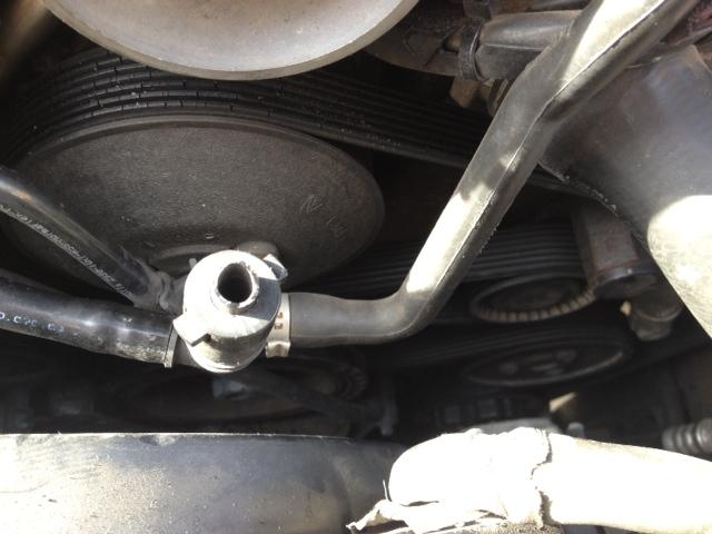

  2. No, I wish I would have though...was so focused on the alternator. I had a coolant leak after a few days a found the plastic T(coolant return line out of alternator) had a crack. Of course you can't just order the T had to order the whole coolant hose (948-106-050 plus the neck 948-106-561). Another pain in the a$$.

  6. Well, finally had some time to put everything back on, replace the vent line and oil pressure sensor. Started right up and is now putting out 13.8 volts. Took the old alternator to AutoZone and bench tested it and it wouldn't put out any volts. Additionally, I checked the codes with the durametric and have a couple of weird codes. I cleared them and will drive around for a bit and re check. My local dealer quoted 7 hours of labor plus $899 for the alternator. Its definitely a pain but well worth it.

  12. Update Replaced both batteries, checked all connections and still not kicking out any voltage. Just replaced the liquid cooled alternator. Major pain in the a$$. On top of that its not working yet because I broke two pieces. The oil sending sensor and a breather T at the top. See pictures
