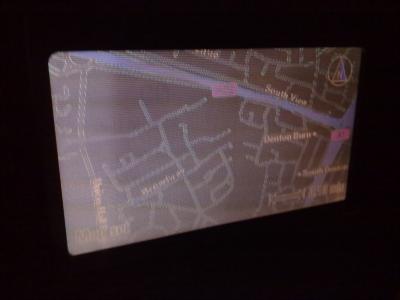

  2. OK so I managed to buy a screen from Portugal in the end for 240 Euros, it arrived, i've fitted it and all is back to normal - RESULT! very happy :)
  3. Maple replied and want in the region of £400 to repair which is a bit steep, the guy from Japan on the eBay auction is saying he can supply a new screen for around £200 and confirms it is compatible with my PCM2.1 - I might get the screen and just fit it myself... but knowing my luck it won't be the right screen!
  4. lol...very funny mudman ;) Thanks Richard, i had already contacted Putnoe and they don't do them, I have contacted the other company. there seems to be someone in Japan who has them (http://cgi.ebay.co.uk/Toshiba-6-5-Display-Audi-RNSE-BENZ-comand-PCM2-1-/170410204314?pt=UK_CarsParts_Vehicles_CarParts_SM&hash=item27ad3d5c9a#ht_808wt_906) - the image is not correct on the auction but i have emailed him. i will let you all know where to get these screens from when i can find out. krist007/and others - i've attached images of what screen is doing - is yours doing the same? im at the stage now whereby tapping the side of the dash is not fixing it, and it just randomly goes back to normal colours from looking like that in the images... i have contacted some scrap merchants, if i was able to buy an entire PCM 2.1 unit - would it replace my existing one without any ECU reprogramming or similar? or is every PCM unit unique to that Cayenne? Thanks
  5. Thanks for the replies guys, I had already seen that and watched the video - I normally spend quite a bit of time searching before asking the question to avoid duplicate questions! I can easily take the unit apart and replace the screen but still have the problem on where to get a screen from... I have found somewhere in America that wants $600 + shipping, but I'd rather buy it from the UK as it may get damaged in transit. BUT it might just be the ribbon cable - i have ordered some torx screwdrivers so as soon as they arrive I will take a closer look. hopefully it is just the ribbon cable, so maybe re-seating that may help (fingers crossed...!)
