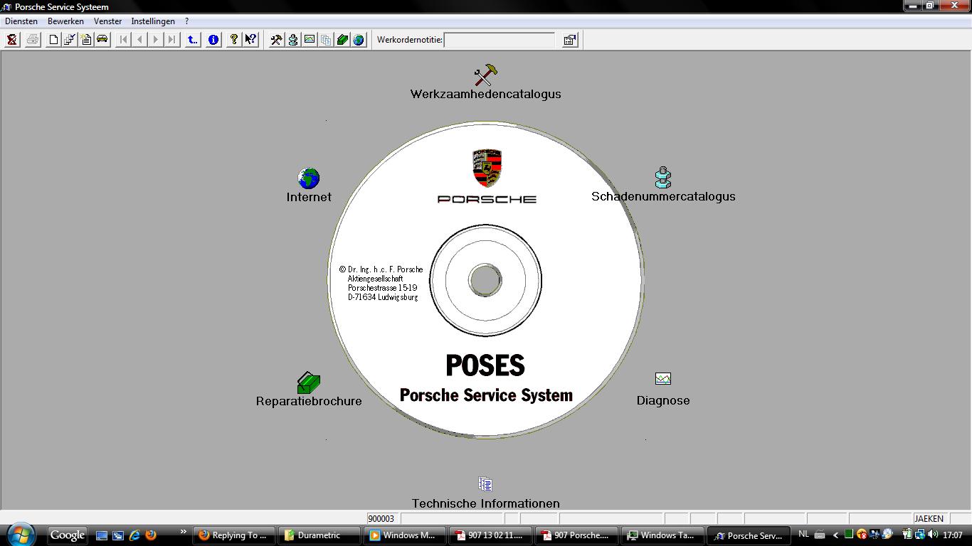

  7. Hi, I could not believe it... but it is the ELSAWIN POSES program! I installed in dutch, but you can change to english
