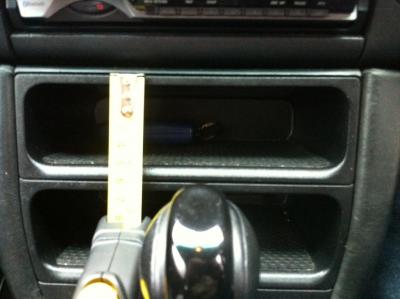

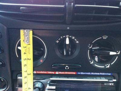

  3. Thanks Rob There is a definite 1cm size difference, you can see the measuring tape in the images, that seems quite significant given the heights only range 6-7. did your boxster S have the pull out tray at the top of the console? that would have reduced the size of your control panel by about 1cm. Could we get a photo of the finished install in your car? Would be extremely good to see it done. Will contact salesaswell ;-)

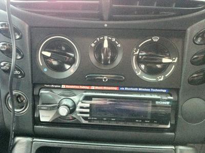

  4. Afraid not. the heaterpanel is 7cm high,the 'standard DIN' is more like 6cm. I've attached better images closeup so you can see. It looks like i need to find a way to fit the LCD controls used for the air con to my car (with or without fitting aircon to go with it!), or i need a lower tray about 1cm shorter to make room for the panel above it where the top tray currently is, or simpyl a shorter blanking plate for where the lower tray currently is.
