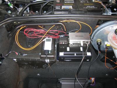

  2. The pics are from my install. It was from a 987S with PCM & NAV. The pic shows the NAV drive as oppossed to a CD changer. It should be very similar to a 997 front trunk (unless its a C4).

  4. I have attached a picture from before cleaning up the installation. In this picture, the cables still need to be organized and the front trunk plastic covers need to be reinstalled. I connected the Gateway 500 by tapping into the connectors going into the back of the NAV drive. The optical connection was very easy - the instructions in the Gateway 500 were clear and all required parts (couplers, optical cables, etc.) were included. It entailed unplugging the optical connector from the back of the DVD drive and unfastening one of the optical cables from the connector followed by inserting one of the included optical cables back into the connector. Basically, the cable that was unplugged from the DVD drive goes into the Gateway 500, and the new cable goes between the Gateway 500 and the DVD drive connector. If your car doesn't have a DVD drive, you will need to perform this procedure on some other MOST component (head unit, amplifier, etc.). The DVD drive was convenient because it is very accessible. The amplifier is hard to reach with the optical connections hiding behind the speaker wires, and the head unit requires removal from the center console. The only other thing to connect is power. You will need to find some location to connect the included power cable to get +12V and GND. I soldered the power wires onto the power connector pins the DVD drive.

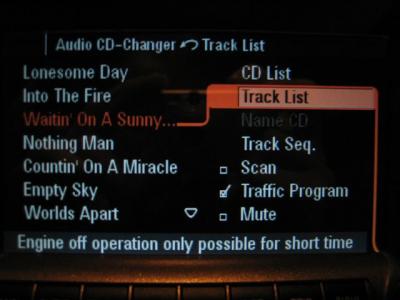

  7. Here are some pics of the PCM display when playing the iPod. Overall, I haven't seen any glitches but I've only taken it for one drive. I wish the navigation of the menus would be better integrated with the PCM rather than through various audio commands (CD #, next/prev track, etc.) but that would have required new firmware for the PCM. Despite this, its not too difficult to get use to, although it is a different paradigm than navigating through the other PCM screens. So far it looks good. Audio quality is great, as well as the extensive song selection! :thumbup:
