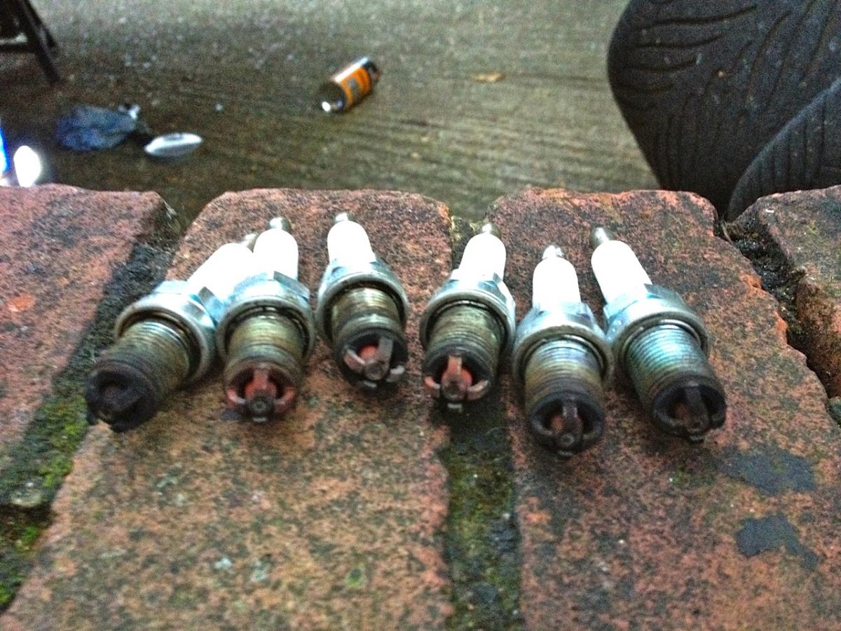

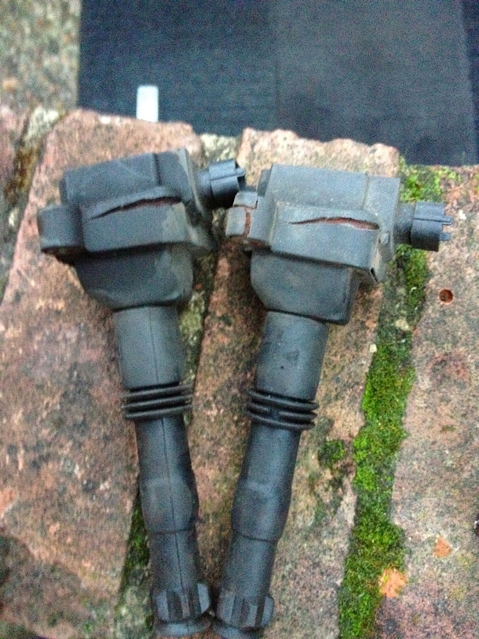

  9. Well I discovered when looking at the car, that the 3 that are sooty are from the side where the gasket from Manifold to cat is leaking !Possible why it was running rich! Ive not put any additive in, but Ive only had the car for few weeks so not sure what previous owner has done! Also 4 coil packs were totally cracked so have replaced all 6 and the plugs ! Will look to see what happens in few thousand miles!
  10. Change my plugs yesterday and noticed one side had red electrodes and the other side wasn't ! what could that mean?
