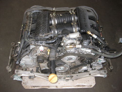

  3. Swapping 996 engine. Current engine a/c works well (cracked cylinder or head though). Would you leave the compressor in the car so not to break the coolant lines or just do the swap and recharge? New (used) engine shown below.
