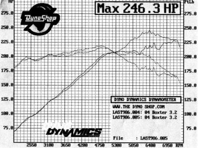

  3. Hi erics, here are my dyno nunbers after danks headers,magnaflow mufflers, evo intake and revo ecu mod..246 h.p.to the wheels is not to bad.the car did not like the giac ecu mode ran pretty rich and preformace was pretty bad..now it runs great and there is a very good gain from 3500 rpm to 5500 rpm..mark over at Hergesheimer in lake forest in o.c. was very helpful.if you can take your car there i think you will like what they can do for you.. :D
