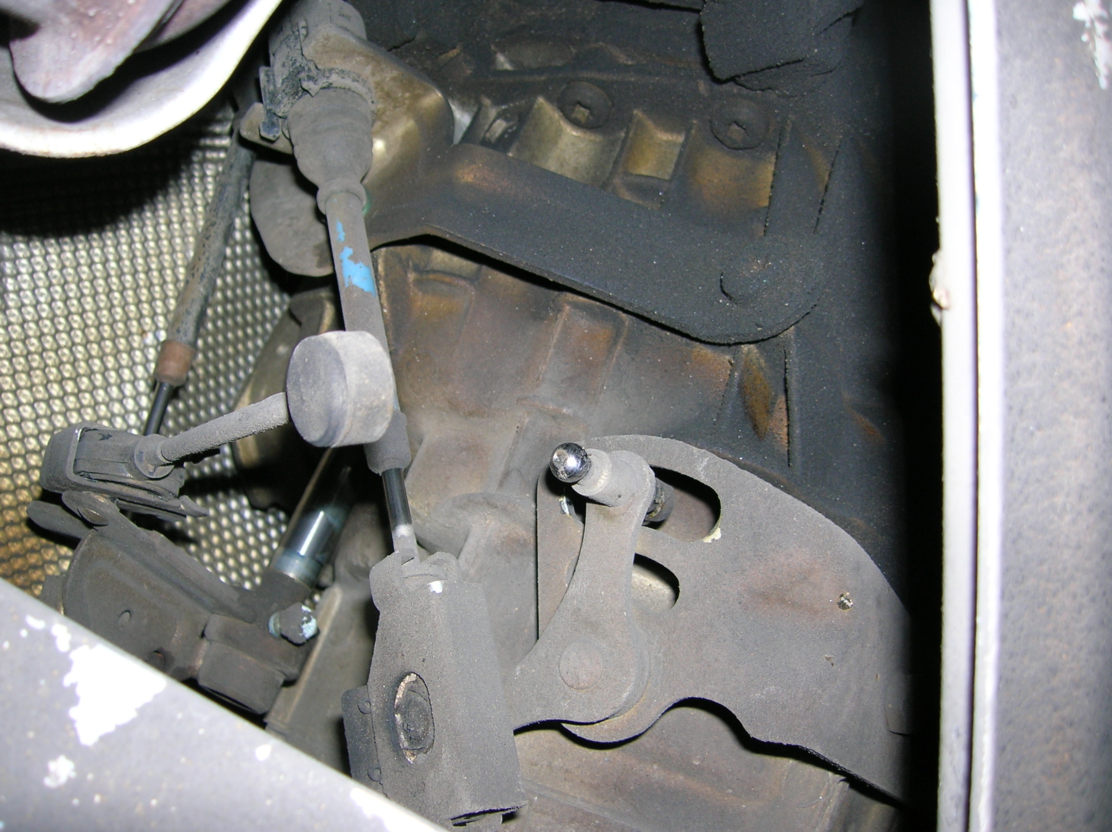

  4. Sorry, seems my original post was not very clear. The cables on my car are fine, both are still clipped firmly in place. If you look a the metal rod (linkage) in the center of the photo you will see there is a cylinder on one end. That cylinder should be fit onto the metal ball joint you can see in the photo. Because the rubber/plastic material in the cylindrical end of the linkage has failed the linkage will no longer stay in place

  6. While my wife was driving home the other day the gear shift lever went slack when moving side to side and she was only able to select 3rd or 4th gear. Since she was close to home she limped the car home. After a quick inspection I was able to find the cause of the problem, a failed end on a linkage on the transmission (see photo). I called the local dealer today and was told the linkage and cable must be replaced together, cost of parts alone $750. Please tell me this is not the case. Can anyone confirm it is possible to replace just the linkage and if so what the part no. may be? Car is a 97 2.5
