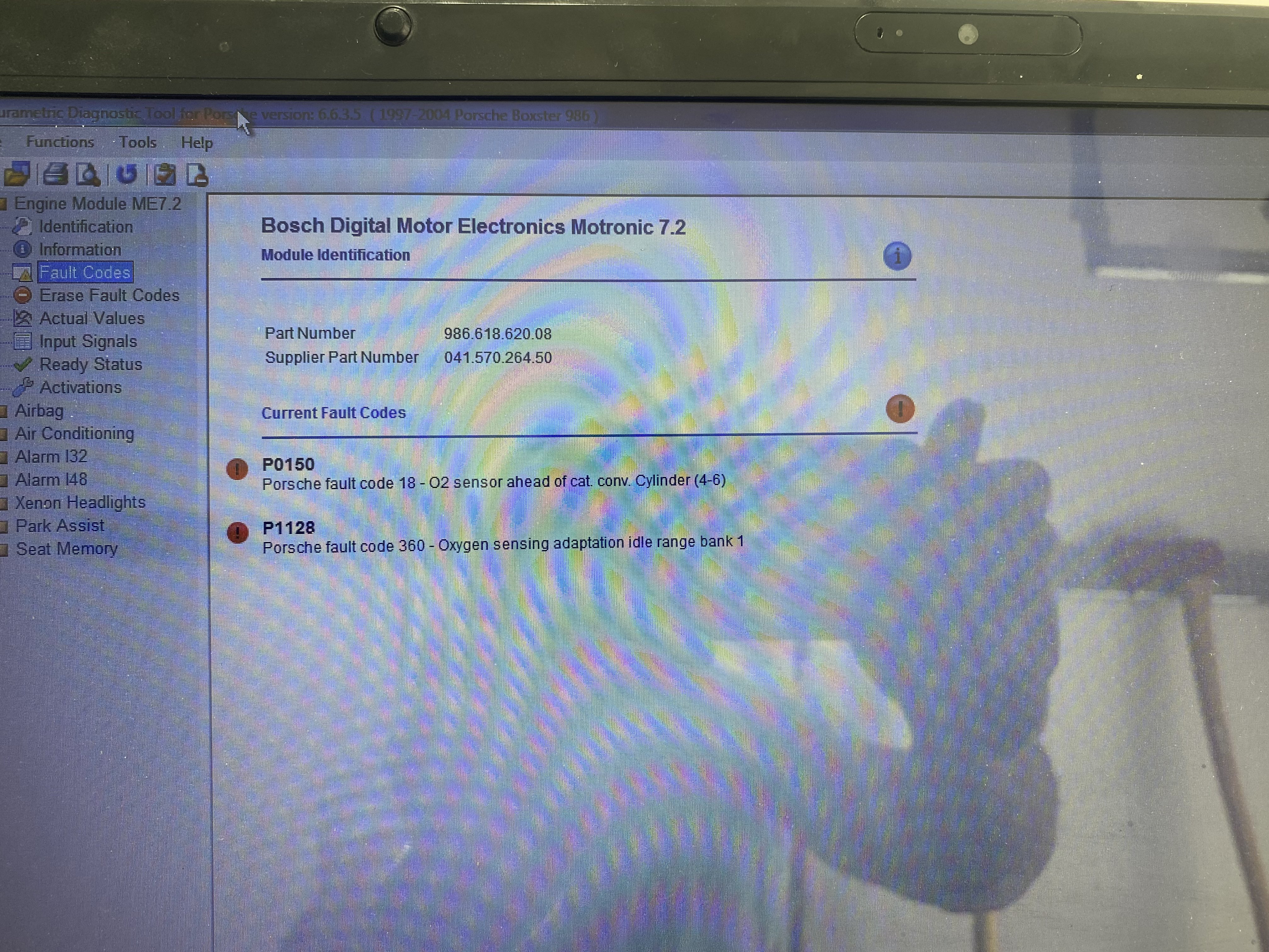

  8. I have P0150 and P1128 codes. I have checked the resistance on the pre cat O2 sensor and I get 3.8 ohm and no shorts to the sensor housing. I have the same results on bank 1 and bank 2. I’ve searched for vacuum leaks and have found nothing so far. Any suggestions?
  9. So I ohmed out the O2 sensor on pins 1 and 2 and got readings of 3.8 ohms. I got the same readings on both the pre cat sensors. Does that mean they are bad? I have some different codes today posted below.
  10. Ok so my CEL came on again today. I’ve been trying to get a long enough cycle on the car to pass emissions. I think this time it’s something different then the problems I had before replacing my AOS. Those errors seem to be fixed. Is this something as simple as replacing my O2 sensor. I replaced the secondary O2 sensors not too long ago. Are the O2 sensors the same for pre and post cat? I’ve attached a image of what my Durametric showed.

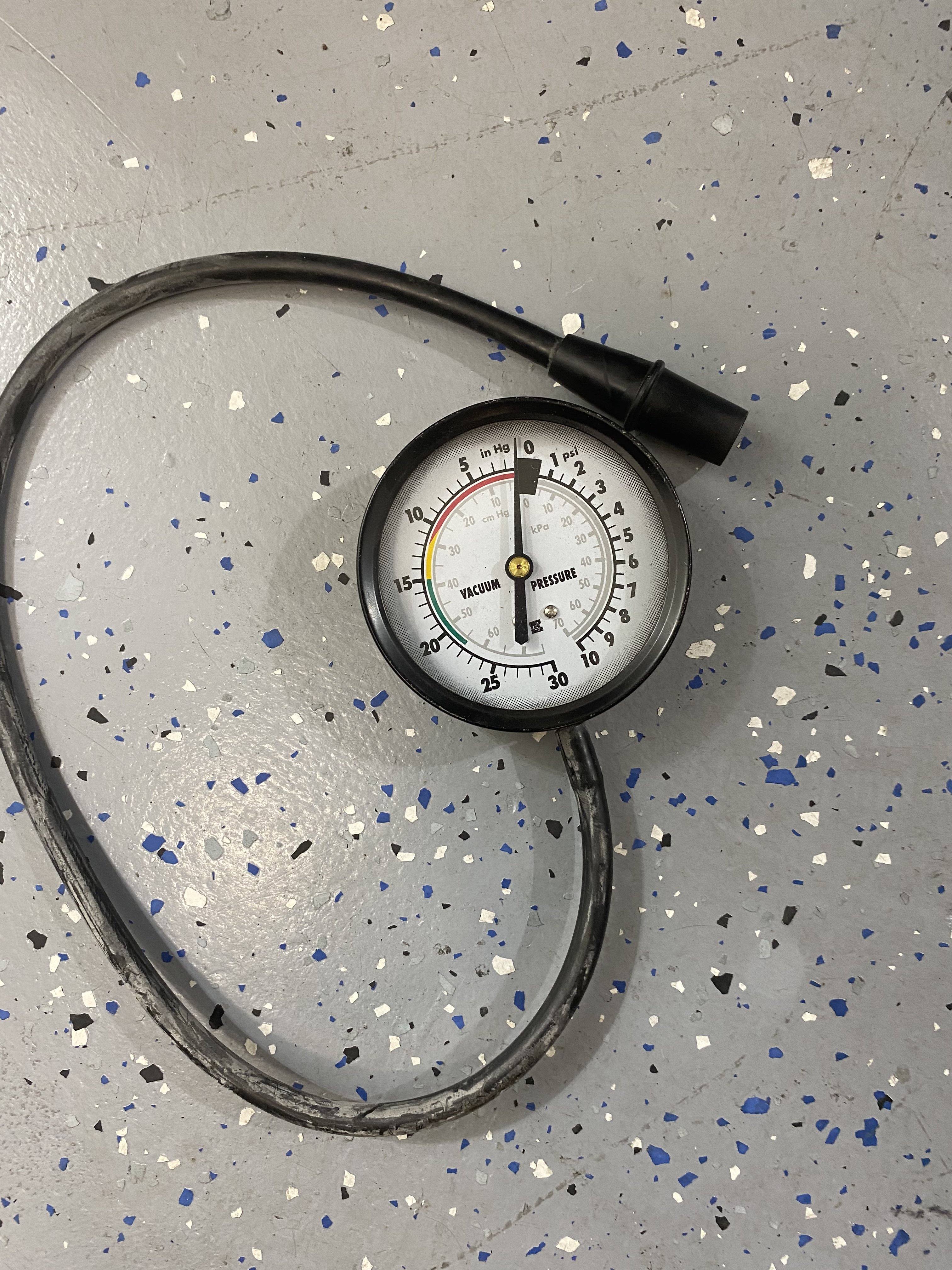

  14. Sorry I miss read my gauge. It reads in Hg. I read about 1 Hg of vacuum.
  15. Could it be my AOS? I tried hooking up a vac gauge to where the oil cap is and it looked low. Less than 1 inch of water.
