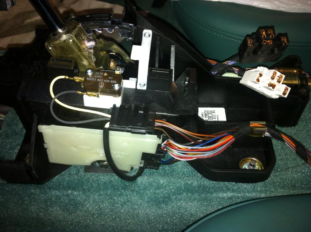

  1. The MFS unit that I have in the above pictures is very easy to remove , and this fixes the problem and is available from Porsche seperatley If not when you remove it make sure your in neautral and disconnect the battery very important Then open the unit clean the contacts and press them back on to the circuit board and it should fix it , I only replaced as its a customers car ,
  2. right new unit fitted today and all solved and for all your guys help on here i will give something back and tell you how to fit the unit and diagnosis . put car in neautral and remove earth on battery ,remove gear knob (silver button pops off , remove clip , slide knob off ) remove J-gate surround very tough clips use a trim tool start from the back BUT be carefull to note which way round the cover goes under this on the bottom of the stalk to cover the hole when shifting , other wise upon refit it will cause you pain not knowing how it fits wasting time working it out because it jams between TIP and Auto when switching between remove ash tray and torx screws under and un-plug light in cubby hole remove rubber matt , undo torx screw remove plastic panel and undo two torx screws under there remove handbrake side trim pops off remove trim (mine was carbon fibre panel ) just above where gear knob was under radio as such remove other relevant screws recline seats fully and remove centre console unit , on passengers side locate white MFS box and remove plugs (reverse light plug very hard to get out !) bridge out plug to confirm your fault (after reconnecting battery Now either replace the unit and OR open up unit and you will see the metal contacts will have come away from the copper strip and so just bend down to make contact again and test ,. now fit the unit back this is why you left the car in neautral , the new switch has a locking pin inside it to keep it in neautral , fit new switch and plug in , reconnect battery and turn ignition on making sure the car has been left in neautral the whole time or it forgets where park is ! now rebuild your centre console 2-3 hours max . that is my rough guide hope it helps someone else !

  4. many thnanks as i thought it was then , i wont be back with the car untill monday morning now, quick question is the new ounit has a metal pin through the middle of the new it by the part number (small hole in middle of part number ) , any ideas what its for and should i remove it on fitting ? can post photo in the next few days
  5. Anyone know which part of this is the reverse light switch ? I have the new MFS unit (white bit ) but want to test the old one first by bridging out the connector first to confirm my thoughts , i think its the blue/black small 2pin plug at the bottom or is it the brown bit on the top ?
  6. Right console out now wanted to get on with it sooner but spent most of today fitting headlights in a DB9 , Has anyone got a wiring diagram for the MFS unit please ?

  12. Thanks for that , I'm stripping it out tomorrow any ideas on procedure ? At the front by your knees do the two side panels pop off ? I've got the ash tray torx and ones under the rubber Matt , I know how to remove the gear stick , Then I'm stuck Have to be extra Carefull with this car can't brake anything ! 815 miles and mark less
  13. Also when I put it in reverse the red dot on the dash signals its in reverse so that works and car does reverse . Have read about a relay under the back seat for park tronic / tiptronic . So its either relay or reverse switch and that's about £900 on the shifter I think . Hopefully someone knows !
  14. I found this in another post saying that box above shown is a ZF box and the MB box has it on the hear selector under the centre consol , This may copy not sure if it will :
