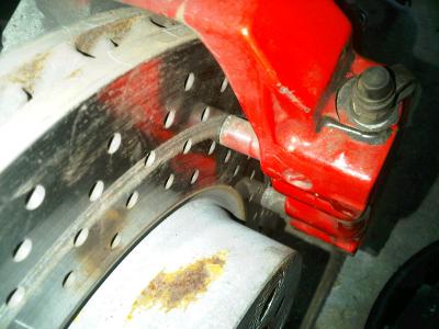

    Vancouver, BC

  1. I have the caliper off and the pads out. I've tried prying and light hammering on the studs both ways to no avail. I'll get a bigger hammer and see if I can get it out. Also going to try some penetrating lube and a small punch. Thanks again for your help.
  2. Thanks for the response. The spring or roll pins you mentioned are still inside the caliper. I've purchased new ones in the hopes I can remove the old pins slide the stud over and install new pins but I'm unsure how to get the pins out aside from drilling them out (which seems like a bad idea).
