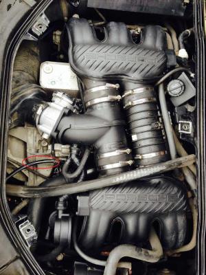

  1. Hi, Anyone who instantly recognize what the tube circled in red is and what it does? Background is I am looking for the cause to codes 1128/1130 combined with the occasional presence of 0410/1411, and since the tube in the picture has been pretty badly mended by a previous owner I am curious if it might be the cause to the codes. Any help is appreciated :-) Thanks Andreas

  3. Hi! I have been reading lots of old threads but still haven't really found someone in a similar situation as me, hence this additional thread on the subject. My car is a 986 S 2002 with 125k miles and I think my MAF is bad because of CEL P1128/P1130 (also P0410/P1411) and a bit of a rough idle. Tried cleaning it two times with no difference.Pulled the MAF and to my surprise I found a 996.606.124.00, which I thought only existed on the 2000 models. Since it is a 2002 model I expected to find a 996.606.125.00. I don't know the history of the car so maybe an earlier owner installed the wrong model. - My question is should I fit a 996.606.124.00 or a 996.606.125.01?And in case the answer is: Depends on your DME flash version, can I determine this using my Durametric? Additional info:Chassis # 9802U661342Engine #M96/216720XXXX Any advice is appreciated Best Andy
