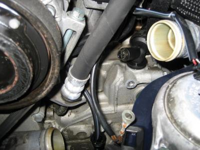

  2. Hi all . Yesterday checked my cam shaft angels with durametric and notist cam position Bank 2 is 0(zero). engine runs weak and rough idle . Desided to check cam position sensor bank 2 out and change it , i know its fit on passanger side toward rear bumper . Loosen the coolant hose and to my suprise there is no sensor on cylinderhead , no hole hor sensor or bolt ..hmm.. all day to day looking for sensor and can not find it . cant find wireharness to sensor . Is it possible there engine/ cylinderhead without sensor , only on bank 1 (driversde) towards backseat ? See pic Bank2 Reg Tictach
