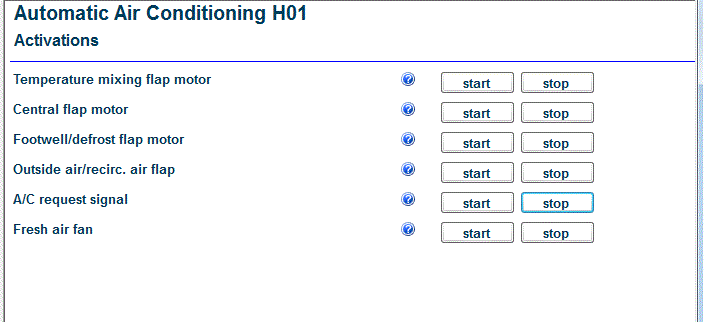

  7. Under A/C Activation, there are six options and two of which include: A/C request signal and Fresh air Fan When activating A/C request signal the Snow flake symbol appears on the climate control display. Activating Fresh Air fan will blow air, since the A/C was on air was cold.

  9. So I ran the diagnostic against the A/C unit. only error I got was 38: PCMCAN timeout fault which I had for a long time. this is due to installing after market head unit.
