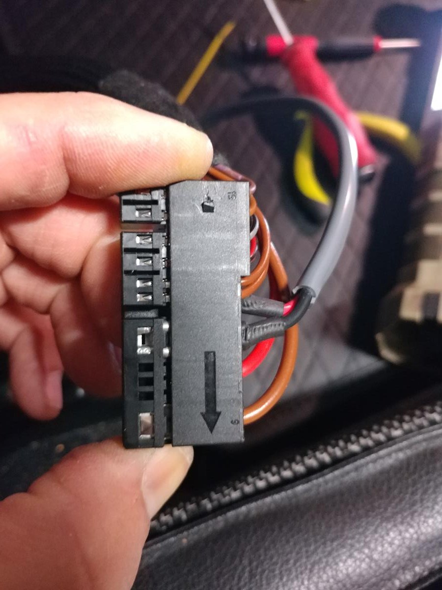

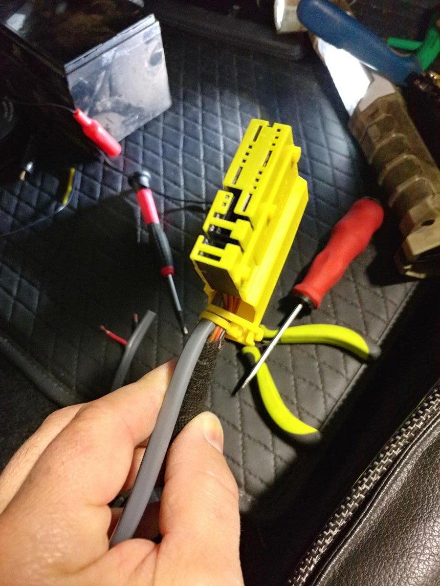

  4. Have another issue as well. Took apart the yellow main connector for the driver's seat and it does not have the extra pair of large male spade connectors for the seat heater like the passenger seat did - just one pair, which I assume are for the main power to the seat, although it also looks like most of the wires in that connector are brown, which would mean grounds. It's possible that everything is powered from the large black box mounted to the bracked under the seat, and that the main yellow plug just grounds all these connections to complete the circuit in the seats. At this point, I'm going to reassemble things the way they were and try and gather additional info to possibly undertake this again in the future with additional info.
