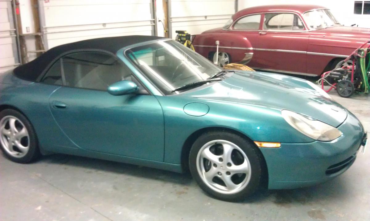

  3. Heres' the old girl. Of course, the first day I get it running in VA, its raining and I have a long gravel driveway. My 13 year old son and I had the best wet drive home from school today !! Looking forward to a sunny day, and top down, and a long cruise through the shenandoah mountains. yeah, it's a funky color but I bought it not running for $8k. Thanks again to all !!!
