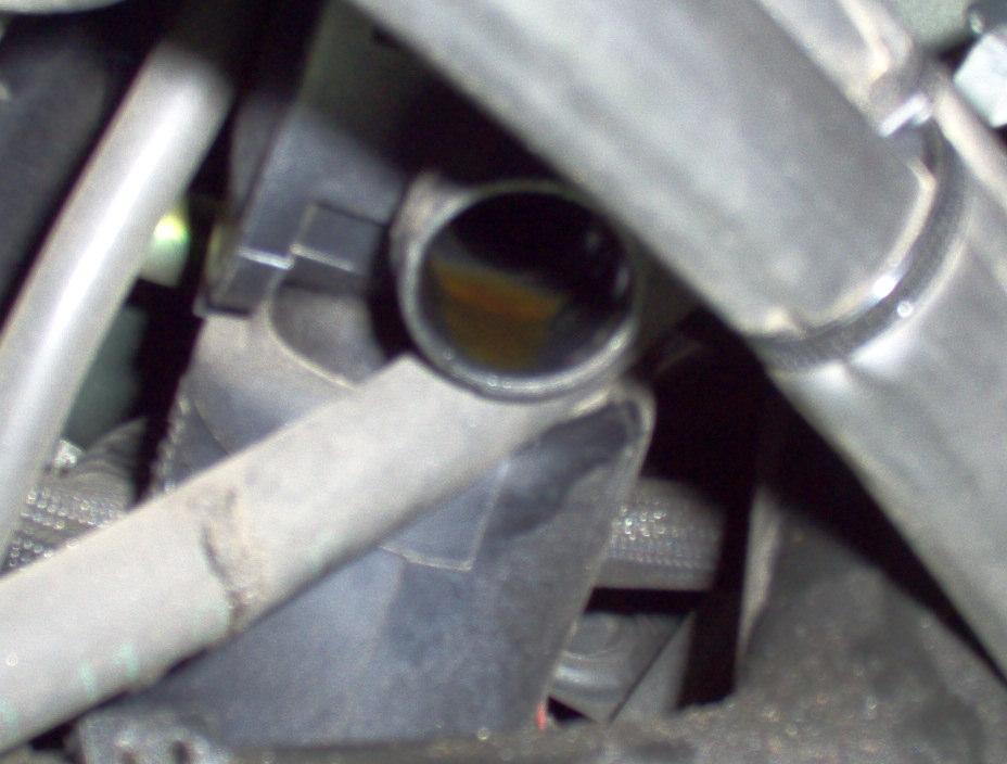

  7. DOH!! OK here are the pics. Started taking the AOS out, figured since I have one on the shelf I might as well change it. Only issue so far is the pipe the the left side of the engine is being a bear to get released from the AOS & there seems to be a electrical connector bracket preventing the last 1/4" of removal. I'm gonna get some rest & tackle it again in the morning.

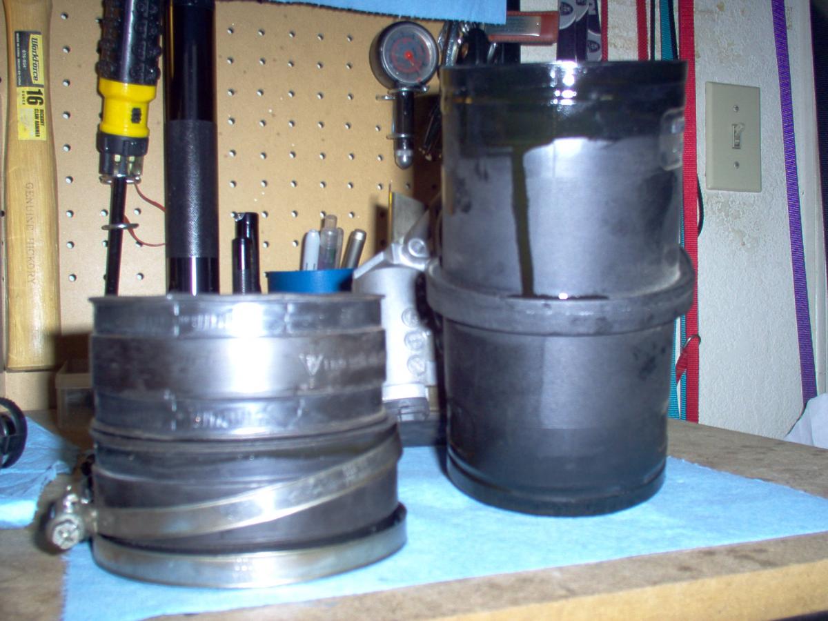

  8. Well I got the TB & crossover tube off & this is what I found. Looks like AOS time? Hmm, I can;t figure out how to upload photos, anyway it seems like a fair amount of oil in the intakes.
