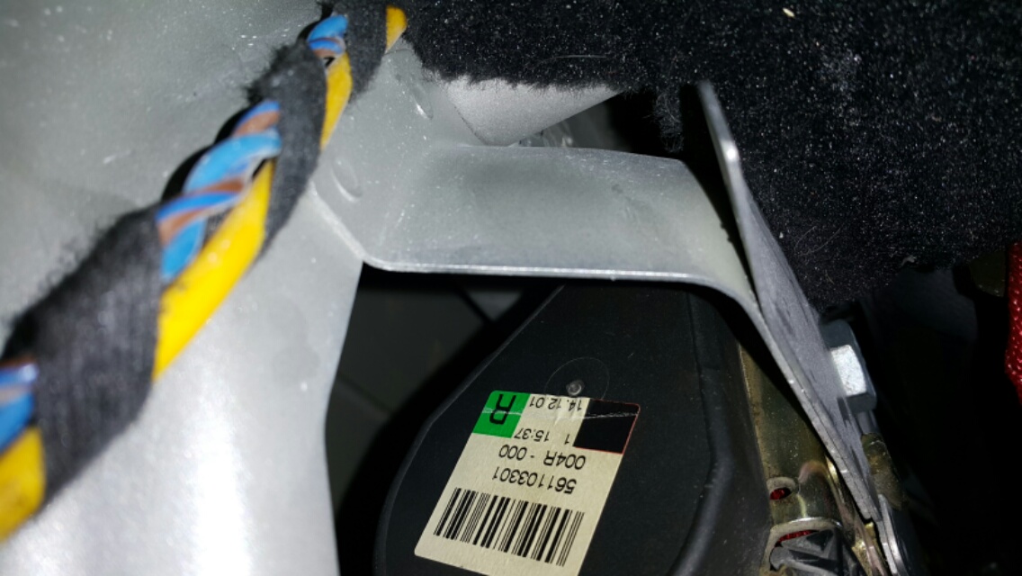

  1. now i have changed the passenger crash sensor (close to the seat belt tensioner) and from 4 fault codes there are still 3 there only the nbr 87 sensor passenger airbag is gone but nbr 56 with the same failure is still there? now i have ordered 2 new seatbelts and a airbag control module from a 2004 on i hope this works or is there another sensor on the passenger side?
  2. here is another pic of the tensionierin our catalogue this are the part numbers until 2001 996.803.033.04 /L 996.803.034.08 /R from 2002 996.803.033.02 /L 996.803.034.04 /R
  3. this is a 2004 GT3 - someone in the forums said that you in the states only have the pyrotechnic tensioners - we in europe have electric? i attach a foto of the tensioner bye wolfgang

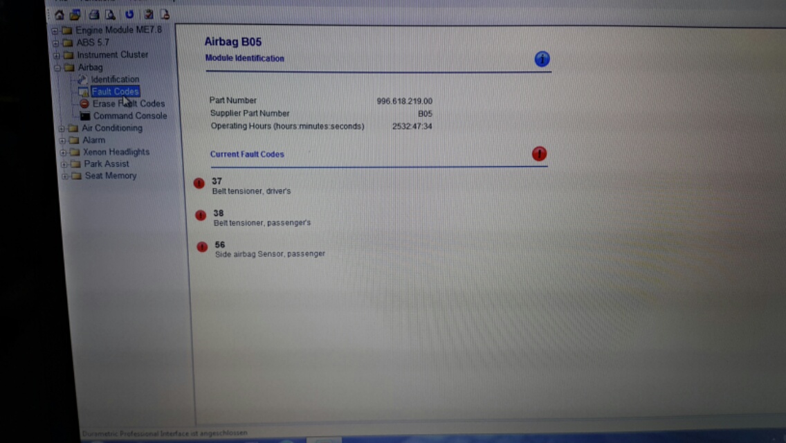

  4. hi i bought a 996 gt3 mk2 last week, the airbag light was on, i checked the fault codes with durarmetric but dont thougt fixing would be no big problem. after going in depth - i saw there is already an other airbag control module installed - nbr 996.618.219.00 (they was build for cars until 2001) the fault codes with this module are 37 belt tensionier, driver´s 38 belt tensionier, passenger´s 56 side airbag sensor, passenger i take the airbag sensor out of the car and ordered a good one (should come in a few days). if i install the original airbag module nbr. 996.618.219.02 the fault codes are 194 control module internal fault 20 ignition circuit driver 23 belt tensioner drivers 25 belt tensioner passengers 27 ignition circuit passenger 3 supply voltage 21 ignition circuit driver 29 ignition circuit - side airbag driver 31 ignition circuit - side airbag passenger 53 side airbag sensor - driver are the two modules compatible? the face lift model uses also other seatbelts? what should i do - buying a control modul 996.618.219.02 or are the seatbealts defect (after an accident?). why my module shows side airbag drivers as defective and with the module from the 2000 996 it shows a failure on the passenger side? how i can check if the belt tensioner is faulty or are the unuseable after an accident?? bye wolfgang i attach two files with the fault codes with the two different modules
