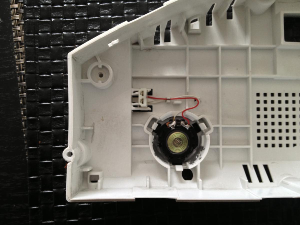

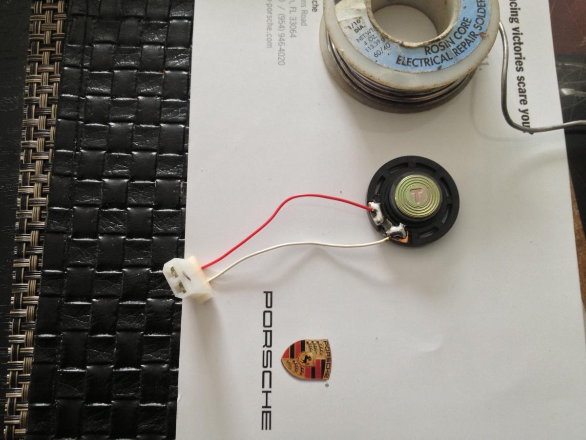

  11. Finally got around to fixing the speaker: I found the part number of the speaker and tried to source it direct from Germany, the manufacturer’s min order qty was 1000pcs (and no US distributor). I found a seller on a Touareg forum offering the exact speaker, for $90 (a $2 speaker). The speaker is 32ohm, I sourced a similar speaker on ebay for $3. It was 2mm smaller in dia so it did not snap into the back of the cluster perfectly; I used a little JB weld to hold it in place. I cut the wires and connector off the old speaker and soldered them to the new one (the clear/white speaker is the failed unit). The toughest part of the job was getting the cluster out. FYI, the cheapest turbo cluster I found was $1700. Hope this helps someone, Thx, Stu PS, the sound and volume are perfect.
