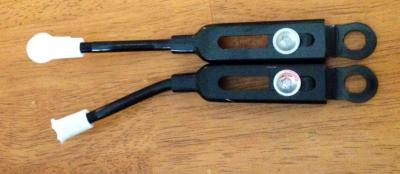

  5. Maurice, I did not get much water in at all, the windows go up and down, but not all the way up. It seems to be waiting for the top to be "fully closed." This might change once I connect all the rods (plastic ones and clam-shell rods) the motor is now running, it would not run when I had the top closed (makes sense). So I am happy that the motor itself and switches are good. I do remember hearing a little thud the last time the clam-shell opened. It is possible it is getting stuck and causing issues. I have all the push rods disconnected now, and will try to connect them again later. I will have a friend operate the roof while I watch it. I have replaced the plastic cups once, and noticed that the push rods were actually installed backwards. I put new rods on it, sadly I did not notice they were on backwards until I had installed them and tested the roof. Those rods were bent a little, I was able to bend them back into spec shape though. Now I am wondering if I should not just buy a new set of perfect rods again. Would the top rods effect the clam-shell opening properly? Thank you, Jack
  6. Ok, good news. The motor runs when I unlatch the top. Bad news, both push rods are getting bent. Does this mean they are too short and I need to screw out the plastic cap a little? Thanks, Jack

  9. No holes in the foam, got the push rods back in. All seems good to go now. Once thing I noticed when removing the broken rods, they were a bit loose and had quite a bit of lateral play in them. Thanks again Maurice, once again appreciate the quick and helpful anser. Jack
  10. What could cause push rods to bend so badly? Could it have been a partially latched top? I wanted to get some opinions before I fit the new ones. Thanks,
