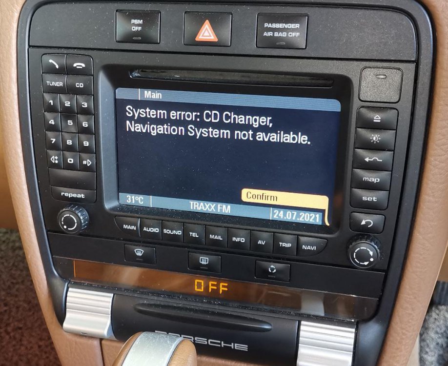

  2. angusc, the issue was wrong date, and i could not set the date manually. after i removed the orange fibre optic line in the navigation unit, i could set the date. ya, i needed to re-plug the orange fibre optic back to the navigation unit, then no more error. tq.
  3. Car: Cayenne 3.6 Tip 2007 (model 957). hi, i have removed all the 3 plugs behind the navigation (under front seat), so that i can set the date manually now. but every time i start the car, the error message (CD changer & navigation system error) appears, how can i disable the error message ?

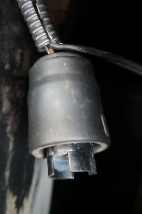

  8. hi, where can i buy this T10 light socket ? i think they are the same one used at side marker , low light (at the top of the front turn signal), & side mirror courtesy light . Car: Cayenne 957 Tip 3.6 many thx !

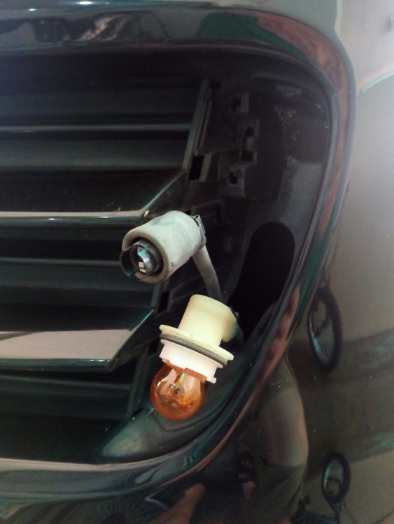

  11. Update: i got error on dash "check front side light" so, i fixed the parking light inside a half inch PVC socket (for domestic water piping ,without thread, grey color). then, i put the parking light together with the PVC socket inside the bumper behind the parking light housing. that eliminates the error on dash. i didn't want to use the load resistor, because the load resistor can get very hot, it may cause damages also it is potentially dangerous to cause fire.
  12. Thanks Loren. i have removed the T10 bulb in the "parking light". Engine running for a few minutes, so far no error code in dash. i plan to convert the T10 bulb to function either as DRL, or welcome light during unlocking car (or both, needs a bit more work on wiring and relay).
  13. Car: Cayenne 957 Tip 3.6, year 2007 i am thinking to replace the bumper light (above the turn indicator) with the LED type. will it give error in dash ? how to remove the bumper light ?
