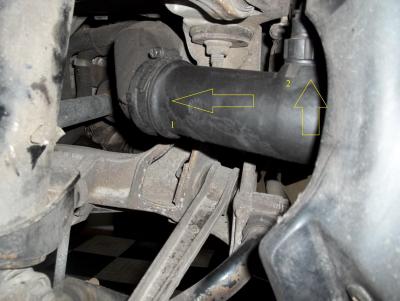

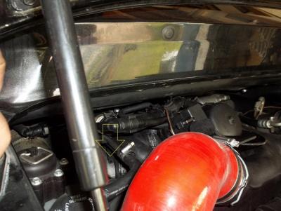

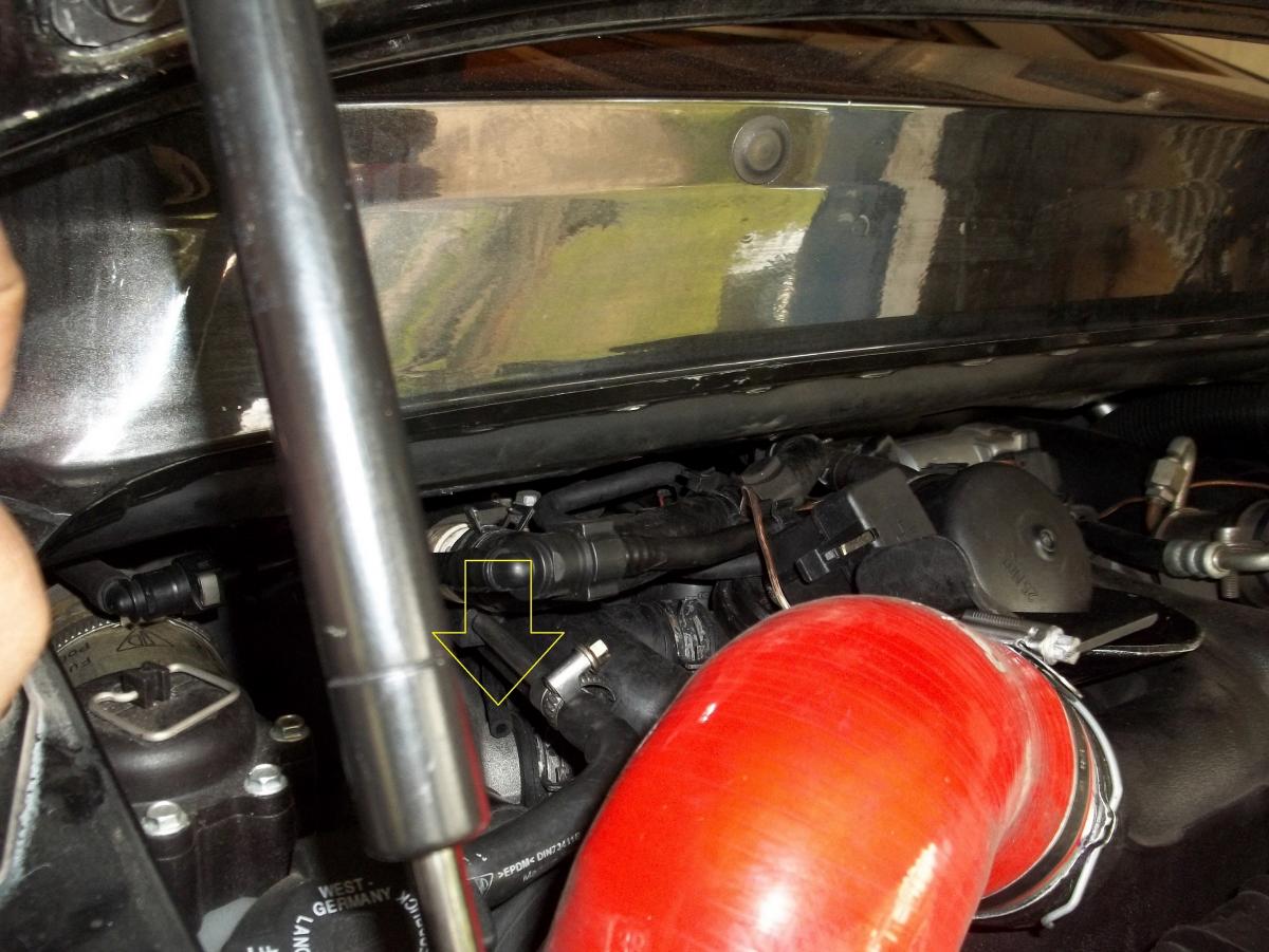

  2. 3. When I applied 20 psi to the system, air was being sucked in at where I have indicated "1" and "2" in the picture. I was not sure what to do so I covered both openings. With the help of a friend, we found what could be a loose vacuum hose (indicated in the picture). Could not figure out where it goes. Am I doing this test wrong? Can someone tell me where the loose hose goes? If you could give me step by step directions on how to do this test, I would really appreciate it. Thanks

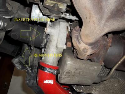

  3. 2. I removed the tubes indicated in the picture on both sides. Inserted the plug on the passenger side and the plug with the air connector on the driver side.

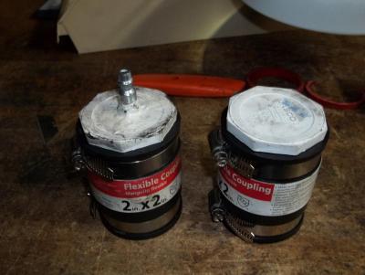

  4. My check engine light came on. When I read the code and searched it looked like I had a vacuum leak. One of the boost hoses had come loose-driver side top on intercooler. I decided it was time to replace the hoses with Forge Boost Hoses and new clips. Got the Forge hoses installed and did the boost leak test as follows: 1. Made one of these setups:
