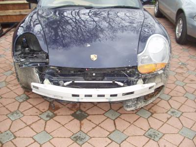

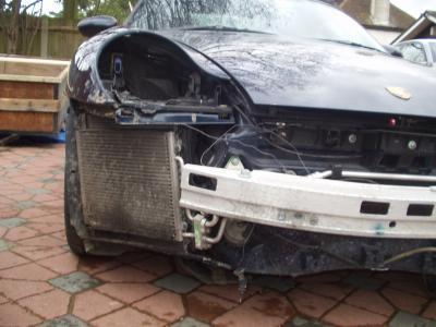

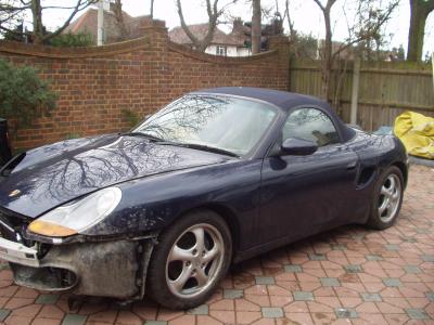

  6. pulled emergency release for boot/bonnet, disconnected battery, did above then reconnected and she cried louder than my niece after her first injection :-D and now the saga continues... taken to Porsche West London where they already had a new set of keys for the car. Clever (not) dicky there tried keys in ignition but no joy... It won't turn. This had already been explained to them and now they totally disagree about the ignition switch possibly being wrong. Had agreement that key I had wasn't working and that they need to get a new one programmed. They now seem to have an idea that the ignition barrel is messed up and needs to be changed along with the whole ignition bit which I think is far fetched Car's history Bought few weeks back as stolen recovered vehicle. On inspection it needed the following - bumper (already sourced) - new drivers side front light (found in front boot of car) - side repeaters (sourced) - drivers side air duct/guide (sourced) - some plastic parts for bumper (grill/side trimmings - also sourced) - new car radio (sourced cdr23 and 6 CD changer but unsure if cdr23 will work with 99 boxster) best pics all advice most sincerely appreciated and respectfully will be taken and acted on Harinder
