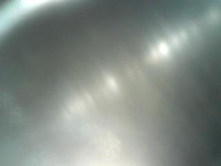

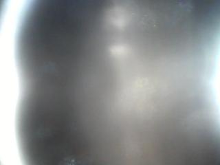

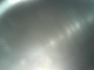

  7. These lines are horizontal as yo can see they curve on the ends to match the cylinder round shape. this is my opinion. Any body correct me if I am wrong
  8. Today I scoped the cylinder where the ticking noise is and I have some pictures for you, Can you tell please is this how a scored cylinder looks like
