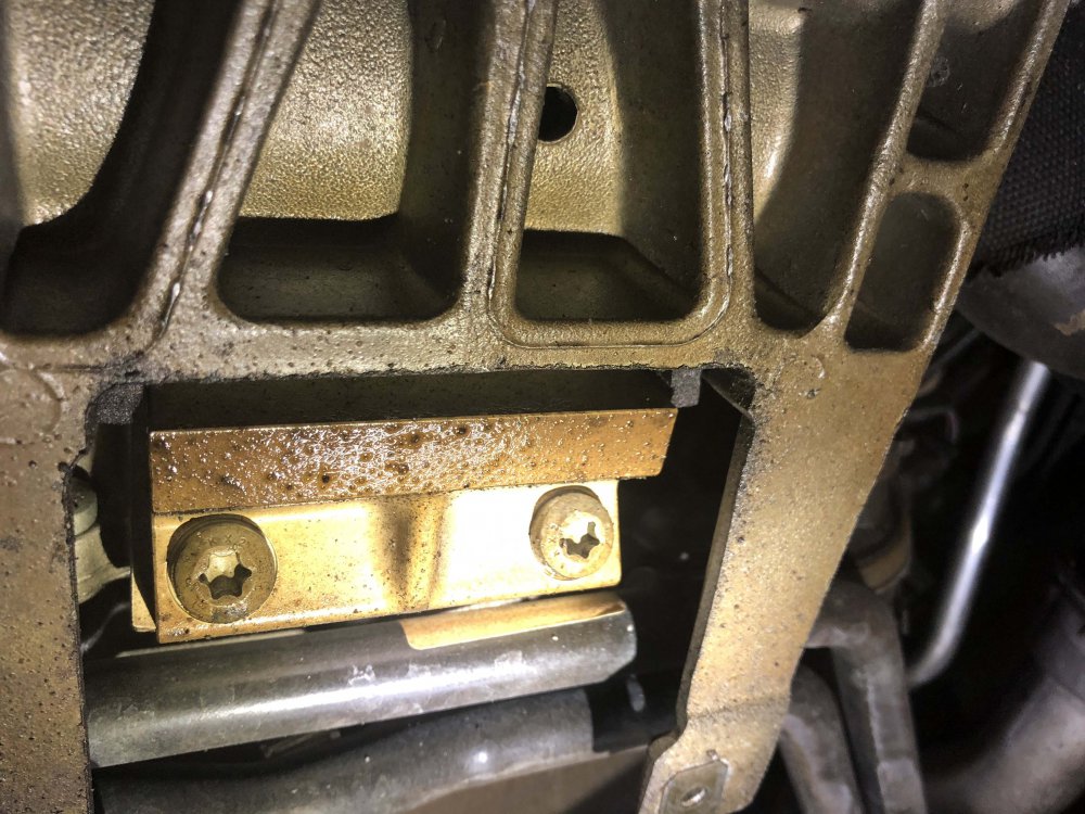

  5. Thank you @JFP in PA I ordered the Porsche hose adapter from my dealer. When I lifted the car, however, noticed that the underbody panel had some fresh oil leak on it -- was not there a few weeks ago when I looked under the car. After removing the panel, it is from the front of the transmission, and it is not red like the Tiptronic fluid. Could it be the all-wheel driving mechanism? PS. Just to clarify, although one pic shows a jack, the car is supported by four jackstands in the factory-recommended positions, plus a fifth stand under the rear suspension on one side. Thought I'd mention that.

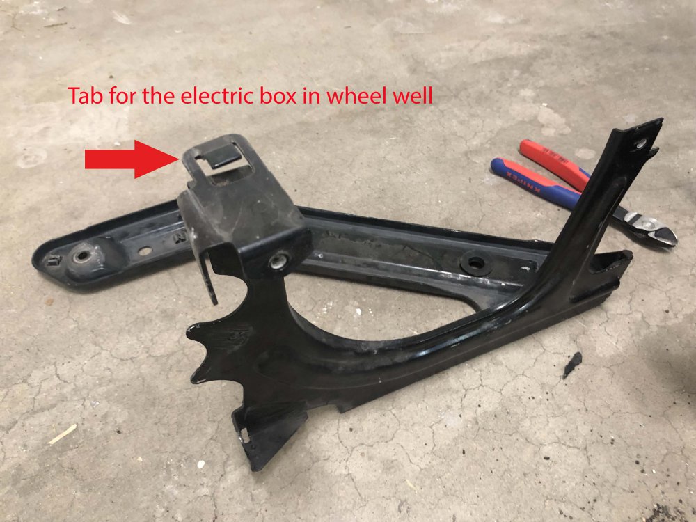

  8. I got a replacement fan from my dealer, and went ahead and replaced it. Problem solved, I can activate both fans in Durametric. Tips for other beginners like me who want to do this swap. 1. I removed the bumper and it is easier to access the setup. You must remove the front wheel well liner and the thin tubular cross brace. 2. It is easiest to remove the bracket supporting the radiator from below. The electric connection box on the inside/top of the bracket and the large radiator hoses connect with torx screws, while the others are hex (10 and 13mm). So you need torx sockets. 3. You don't need to disconnect the radiator vent hose. 4. You don't need to separate the AC condenser from the radiator, but it is easy to do, and allows some wiggle room to clean the debris out. I blew compressed air from the back and vacuumed from the front. Quite a bit of mess came out and the rads still don't look clean. Oh well. 5. The electric connector on the top of the fan assembly (air duct) is tricky. Seems like it should come apart by pulling outward (laterally), but in fact you should grab the inner half and pull it inward. The outer half is attached to the body of the air duct. Luckily I realized this before I broke something. Thanks for the hint that the fan might be a problem. That's why this forum is so great!

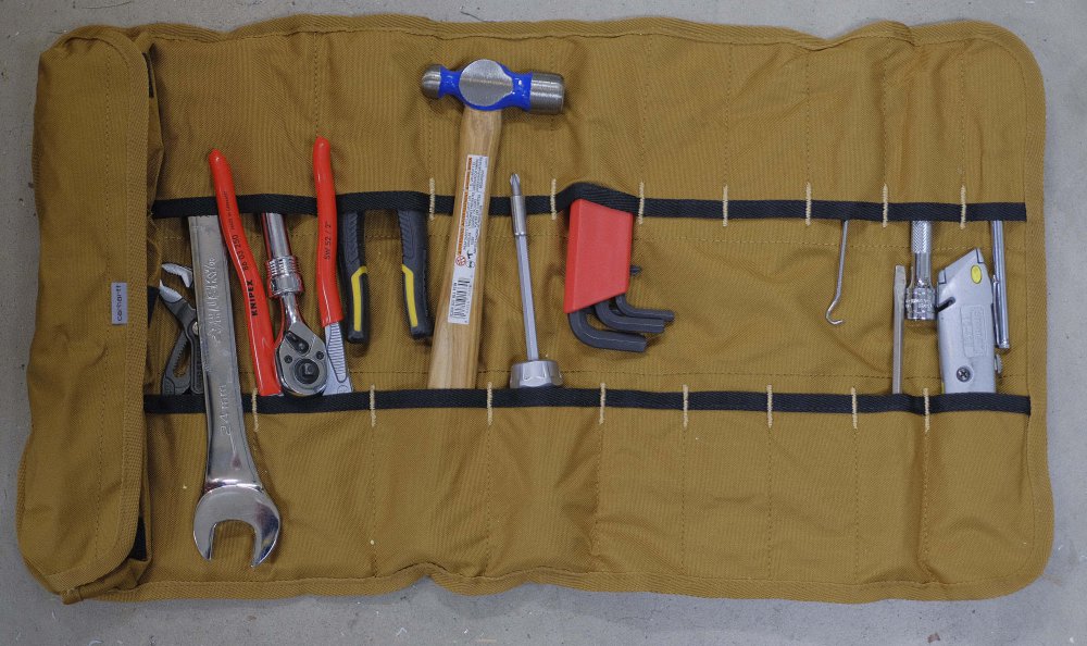

  12. I was wondering what tools do you carry in the car. I realize a cell phone is the best tool, and the frunk cellar (or whatever you wanna call it) has some basics, including the lugnut safety socket. But I take my car on long rides and wonder if I break down in a small town, the local mechanic is not going to have a serpentine belt etc. So I put together a basic toolset, but want to ask for suggestions. Thus far I have spare serpentine belt and the 24mm wrench needed to put it on. 19 mm 3/8" socket with extender and ratchet wrench large adjustable wrench with smooth-surface jaws (Might replace the 24mm as it opens that wide IIRC) medium Knipex Cobra diagonal cutter hammer ratcheting screwdriver with torx and philips bits metric ballhead Allen wrenches boxcutter, mirror, picker, light, gloves, microfiber towels
