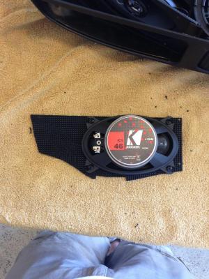

  5. Hello folks, just wanted to share my latest upgrade for my 2002 Boxster S. Several articles exist about mod-ing the rear storage compartment for speaker installation however all the articles I found talk about installing a single 3.5" speaker or two 3.5" speakers per side. I wanted some additional low end in the system and was worried that 3.5" speakers just wouldn't deliver the lows. Well, good news, I found that a 4x6" speaker JUST BARELY fits. So if you are planning on a speaker mod, check out my pics below... Pic1 - Front view of speaker mounted in plastic bracket (used cardboard to trim to shape then used as pattern on plastic) Pic 2 - Rear view of same Pic 3 - View installed in rear utility box Pic 4 - Wire mesh waste paper basket (from Ikea) used to make speaker grills Pic 5 - Project complete, installed back in car. Tools / Materials used: Thin cardboard / Scissors to trim to the correct pattern Sheet of plastic ($8.00 at car stereo installation dealer) Wire mesh waste paper basket for speaker covers Dremel tool (Drill and Grinder tip) to shape plastic and drill out speaker hole Tin Snips to cut wire mesh to fit Hot Glue Gun to glue wire mesh to speaker opening 2 Kicker 4x6 speakers ($80.00 at local car stereo dealer) The sound is MUCH better than the stock front and side speakers, the jury is still out on the sound quality of the kicker speakers. I might try different speakers (Pioneer / Alpine etc) but for now these sound fine. Please update the thread if you do this mod and share your pics / experiences. Thanks and happy Mod-ing. FrankyZambony
