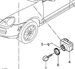

  11. Hi All! I was looking thru PET and found a part with no description. See pic. It is number 5 and when I pick on it, I get a message saying "Part number unknown" Anyone any idea what it is? Sprint.
