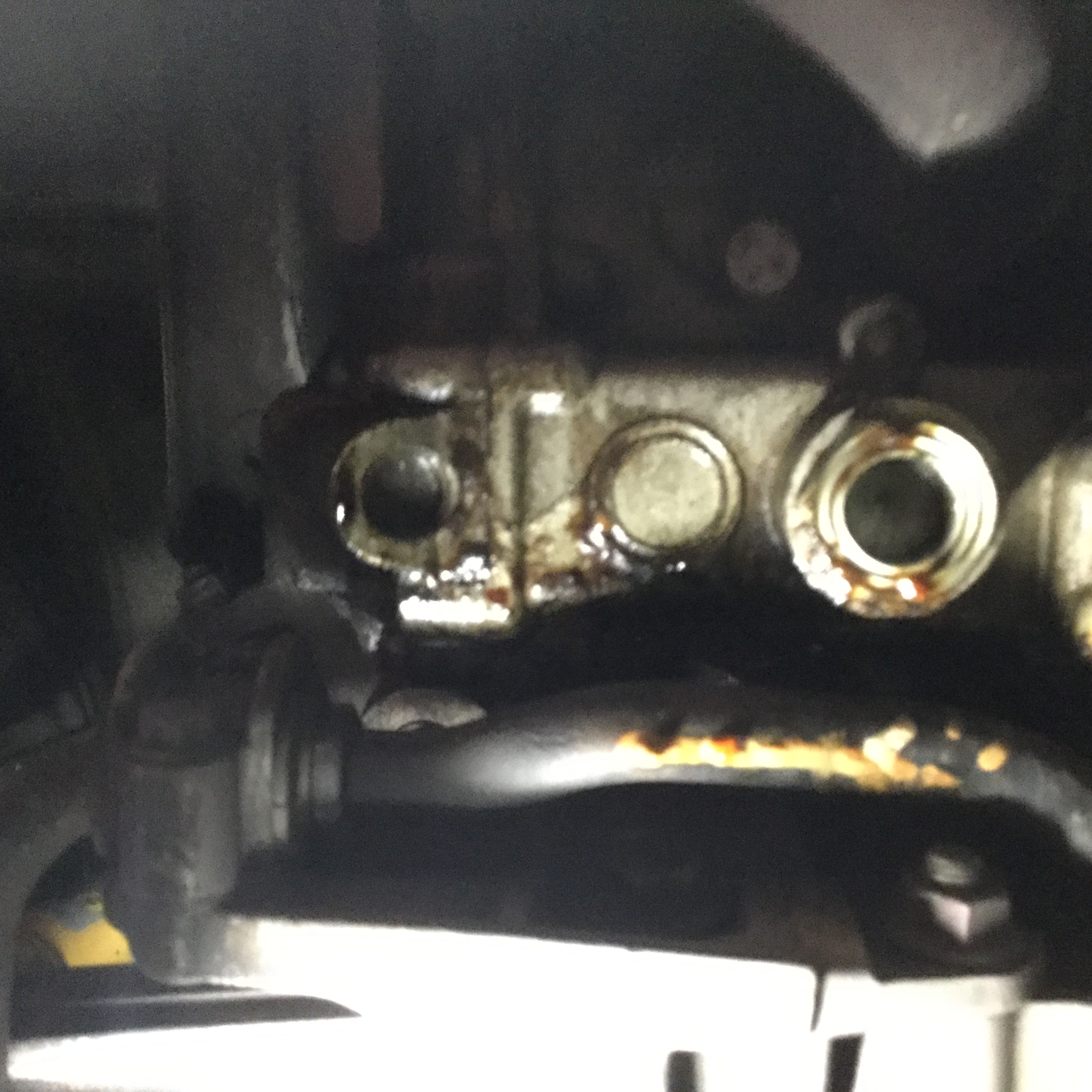

  1. Typical area to find AOS leak. Mine was on the flexible, rubber boot connected to the AOS and engine.
  2. This is the low point on this part of the engine. My leak came from much higher (typical problem), the AOS (air/oil separator). The AOS has a rubber, flexible coupling the was not installed properly. The AOS needed to be replaced, a truly miserable experience . . . but doable.
