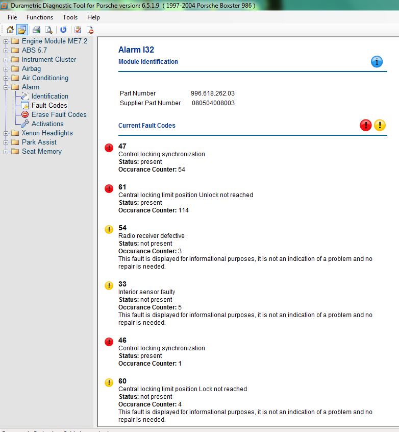

  4. The Jetta lock for 2006 is the same part as a 2001? John

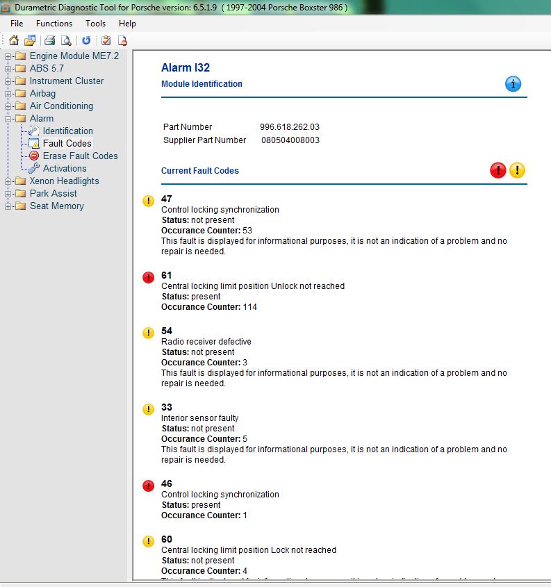

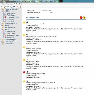

  5. After lunch today I hooked up the durametric and was able to see faults again so I rant the test requested. Here are 3 images. Yesterday Today after clearing faults and pressing lock/unlock Again after another test of pressing lock/unlock Anything conclusive from this?

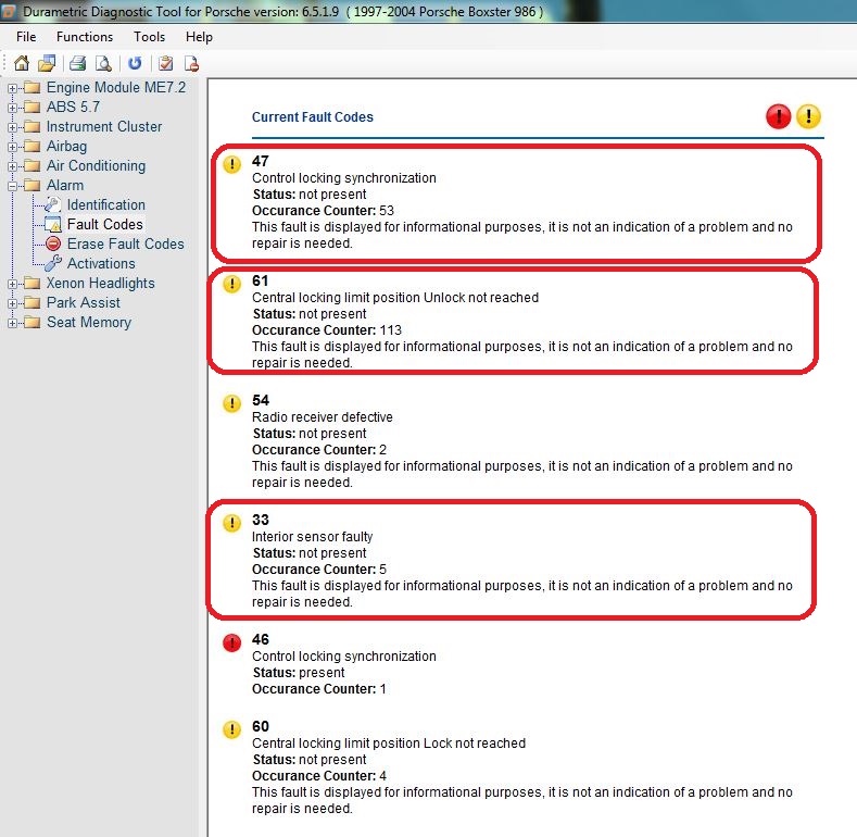

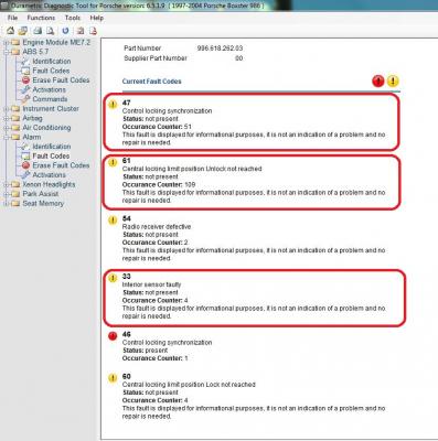

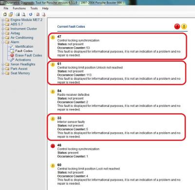

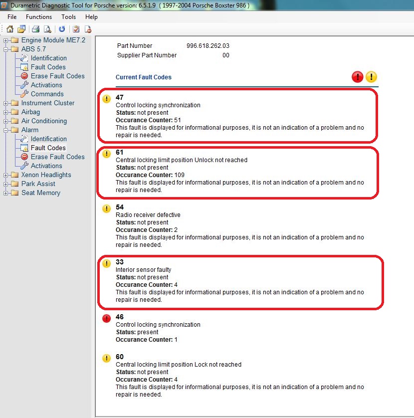

  6. I received a response from Durametric. They asked me to generate logs while I checked the Alarm and sure enough it worked this time. I took a screen capture of the logs and then pressed clear logs. Once that operation was complete, I was back to my problem of no data. Here is a shot of the March 3 Alarm Codes Here is a shot of the March 9 Alarm Codes Note that 3 of them (circled in red) have incremented in the last 6 days. Code 47 has incremented by 2 Code 61 has incremented by 4 Code 33 has incremented by 1 I will check again today but the lock system has been behaving itself (although this morning I could not lock the car with the lock button on the key head :cursing: ) I am again at the point where I think that replacing the door lock is my next logical step. John
  7. This is excellent, Thank you!Does Durametric order the fault codes by recent occurrence? Looking at the occurrence numbers Fault 47-51 times Fault 61-109 times All other codes are 1-4 times. The problem I have happens a LOT. Would replacing door lock mechanism be a logical next step? John

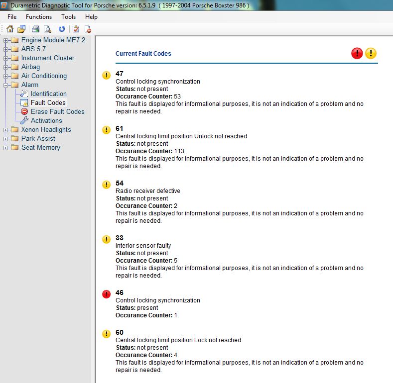

  9. I called Durametric and determined what the issue was. I now have codes! I did not clear anything as I wanted to get input. Here is the list. I know why code 54 is there but what do the other codes tell? John
