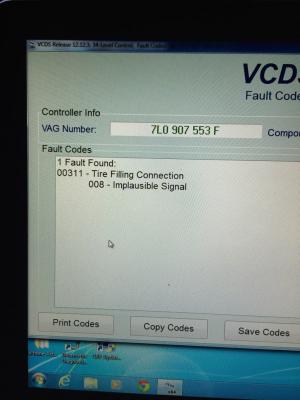

  11. I was able to make an adapter to get the vagcom to work and I get this code and erase it and it comes right back not sure where to go from here I also notice I can't lower or raise the truck .thanks again
